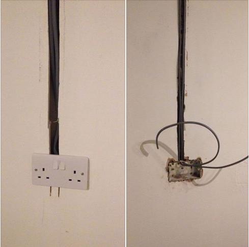

Todays efforts...
Two chases going loft to ground floor, backboxes installed on the ground floor and even a socket on one of them. Cables going to the loft and second floor but no backboxes/sockets on the second floor yet.
edit: I was also able to do a chase for a light switch where there is already a light switch because the existing installation has the cable going diagonally up and across. Unfortunately this kind of thing is everywhere in the house. It felt very strange chasing from the ceiling down to a light switch while the light was still on, but it was safely done.
