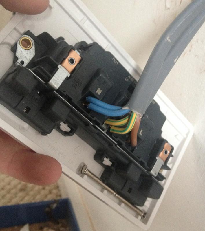

normally much more grey insulation would be removed.
and more spare slack on the wires.
It's a bit of a give away that an electrician hasn't done it!
But it looks tidy and safe. (well maybe the wires are too tight)
Thanks Andy, appreciate the feedback. Perhaps I've tried to be a little too tidy. How much grey "matter" would you normally remove? Are you suggesting I should leave additional slack in both the core wires and the grey insulated wire? Or just one (or the other).
Usually the grey should enter the back box by only 1cm max.
There should be spare slack in the brown & blue wires.
Enough to pull the socket away from the wall and make connections.
Not too much that its a pain when screwing it back to the wall.
Have a look at the existing sockets in your house. These maybe a good example
If in future you need to change the sockets (and use a different brand) the wires would not be long enough to reach.
Just as well your using MK!
If I was preparing a cable to come into the socket, I would leave enough cable so that it would reach the far corner of the back box.
Once the grey is removed, there would be enough wire left for slack etc.
. The reason I haven't run an additional ground wire to the backbox is that these sockets (MK Logic Plus) don't seem to hold 3 wires securely. They do, eventually, but they are a massive faff and it's very hit and miss. The backbox is, however, grounded via the faceplate screws.
Very few do that nowadays
As said theres too much grey sheathing, hence the trouble your having getting them in.
Mk easily takes 3 earths, as there small its sometimes better too double them over for a more secure fit.
I also find it easier and neater to use 2mm earth sleeving
However regs allow you to ommit the flylead

I had a weekend off last weekend. Somebody requested a picture of how I'm wiring the sockets. Here we go:
Before someone says the back box isn't grounded, it is. The reason I haven't run an additional ground wire to the backbox is that these sockets (MK Logic Plus) don't seem to hold 3 wires securely. They do, eventually, but they are a massive faff and it's very hit and miss. The backbox is, however, grounded via the faceplate screws.
I've also been securing wires in chases, I went with hot glue which seems to be working very well. They'll be further secured with plaster once we patch up.
I ran a 1.5mm cable through a very very fiddly route including running through a beam. It took a while but the result is far better than the original cable route.
A few more sockets are in, and 1/3rd of the house is a few hours away from being done.
I'll be testing continuity of the existing runs soon, and then moving on to the next section of the house.
Nothing is connected, it's all still just decorative wiring.
I'm here for advice and support, not judgement. So please, if you don't have something constructive to add, please just refrain from posting. If the advice is "don't do it yourself", this advice has already been offered, thank you.

As others have said, you really want a lot more of the grey sheathing removed - generally back to the point that the cables enter the box (through a grommet).
