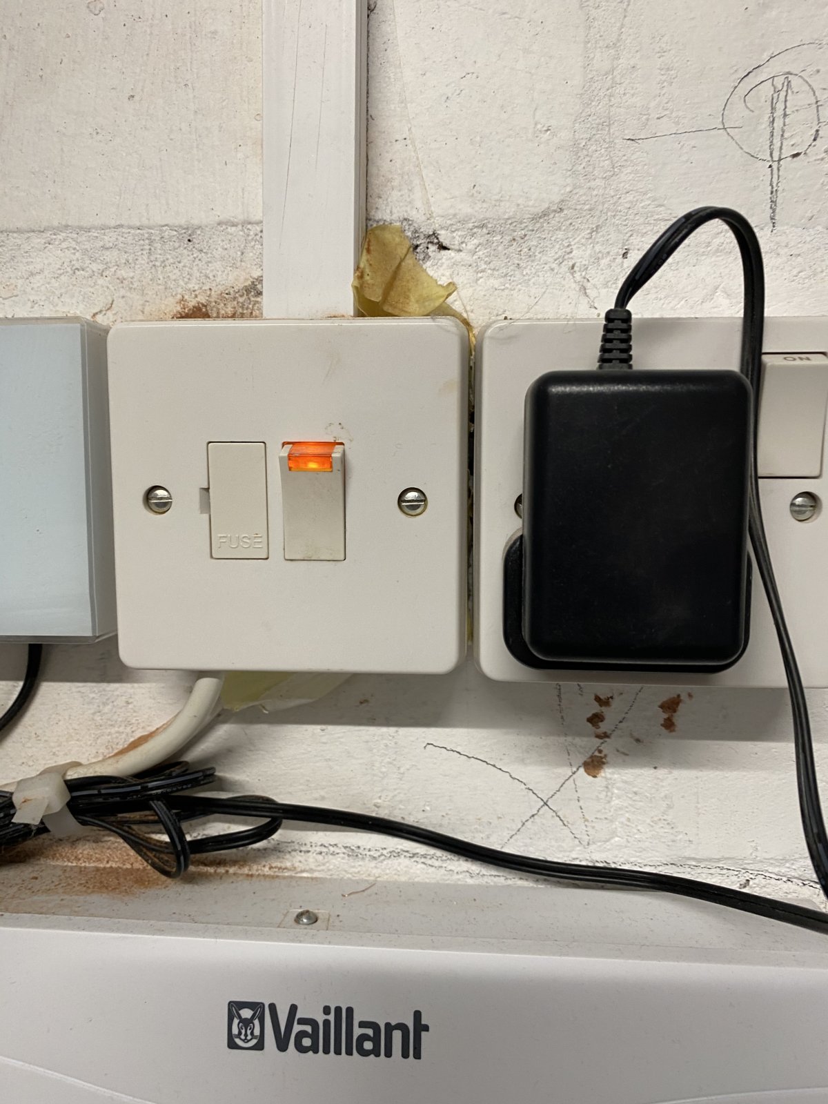

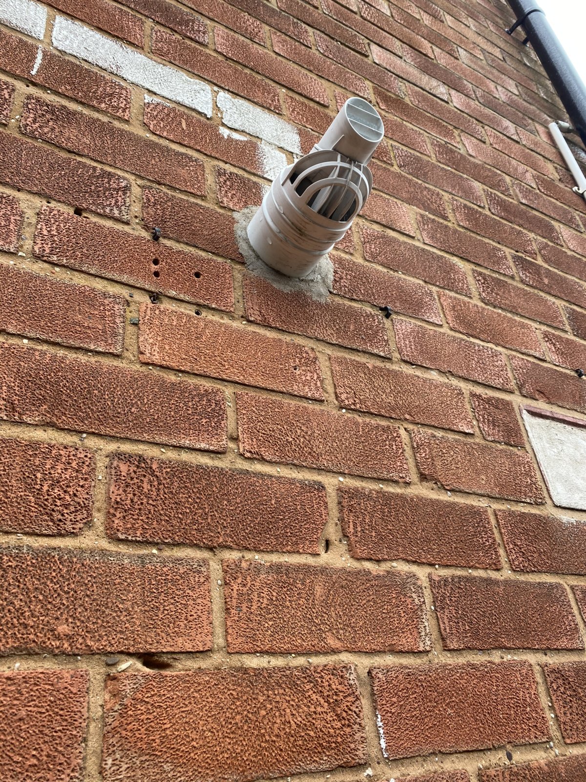

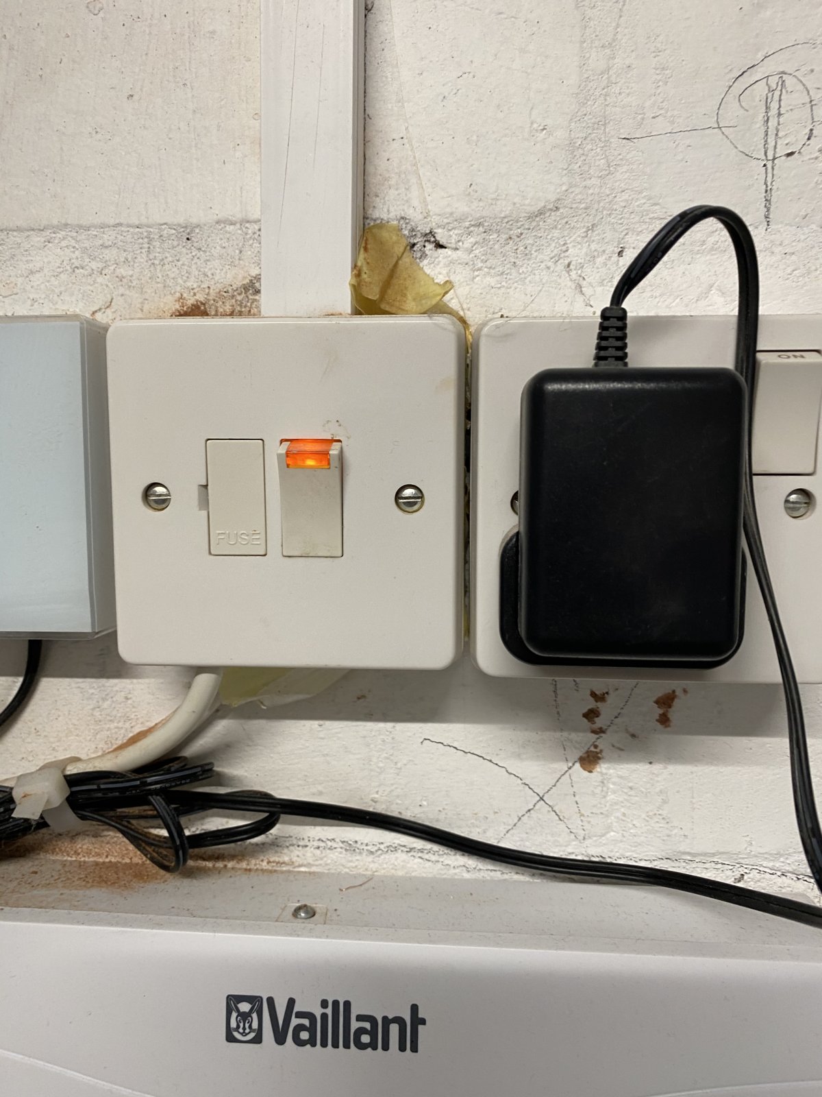

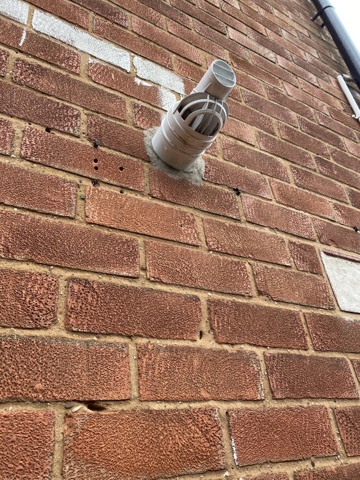

Hi I got a boiler service from groupon. It was only 37 quid so I took the risk.
service went ok but he pointed out the following.
he did say he needed to check of metal on outside of flu, and flu was sticking out too much. He rang valiant and they said it’s ok.
he said the boiler flu needs a sleeve outside
he said the fuse next to boiler needs to be 13a. Is this still the case with thermostat plug??

He's right that the flue is too long. It's also missing a weathering collar, which would have been supplied with it. Presumably your installers couldn't be assed to cut the flue to the right size, so binned the collar as it would have made the issue glaringly obvious - it fits onto a ridge at the junction of the flue and terminal.
He's wrong on the fuse, it should be 5a max, normally 3a for a gas boiler.

He actually rang valiant and they said it’s ok to have glue that long as metal is waterproof.

The boiler was connected to a light switch on a 15A circuit which was changed to a 3A fcu, so it's worth having things checked even if they were already workings. But your thermostat wouldn't need a separate fuse if it's just plugged in.
