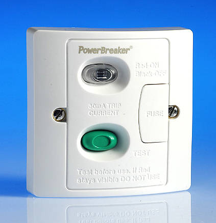

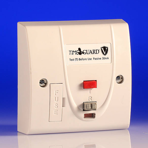

If it isn't, or if you don't have any RCD, then you should power the pump via an RCD fused spur, like one of these:
If you can find a switched one, that would also do for your isolator, but I'm not sure there is such a beast.
hi, no the CU doesn't have any test button on so i will need to get a RCB i've seen the powerbreaker version in BnQ which is same price from there as screwfix so will get this 1.
can i run this RCB from a spur off socket cable with a junction box? any pictures of the isolator that i need and how do i wire this to the RCB?

RCD
Better to put it directly onto the ring, but you can use a spur cable as you describe, provided that socket is not itself a spur

Those are RCD FCUs, so you might not need a second FCU. What is the rating of the gubbins for the spa bath?
Is the shower over the bath, or is it possible that you could be using the spa and the shower simultaneously?
hi m8, the shower is a seperate enclosure, the spa needs 13amp and the shower needs 3 amp thats why i thought to connect it to another FCU with a 3 amp instead of the 13amp
andy
There's no way to separate the FCU and RCD functions in those units, so both appliances would be coming off the same 13A fuse. This is the wrong value for the shower, and the total load would be too great for the FCU.
So if you want both appliances on an RCD, you'll need two of them.
