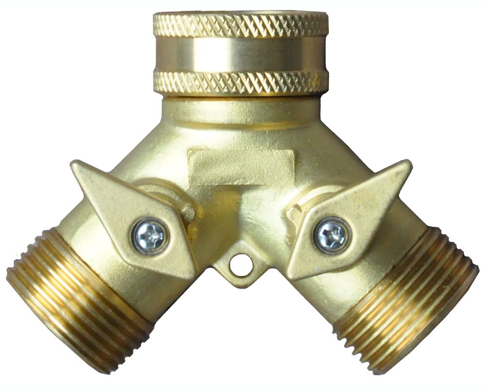

    I only have the cold feed as shown in picture 2, from my research do I need a Y PIECE, but certain reviews have said a plastic one is no good, but a brass one would do the trick!

    Unless someone knows better, you will struggle to find a 3/4" 'Y' piece in brass.
    British Gas - who we supply with the plastic one - wanted to change to a brass one.
    All we could find were Far Eastern manufacturers who wanted a commitment for thousands of them.
    • Thanks Thanks x 1

    You can get them more so from places that deal in irrigation equipment.

    They must be new on the market (or any other excuse to stop me looking a prat :oops: )
    I doubt we looked on ebay.
