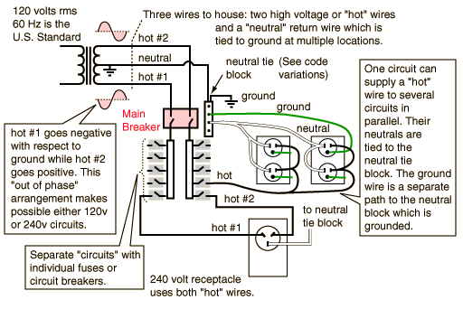

In case you are lost in this thread, here's a picture: -
10 amp on hot#1
10 amp on hot#2
00 amp on the neutral
and
10 amp on hot#1
25 amp on hot#2
15 amp on the neutral
so you can see that the neutral is designed to carry unbalanced current
Thank you for submitting the electrical schematic Very Nice
