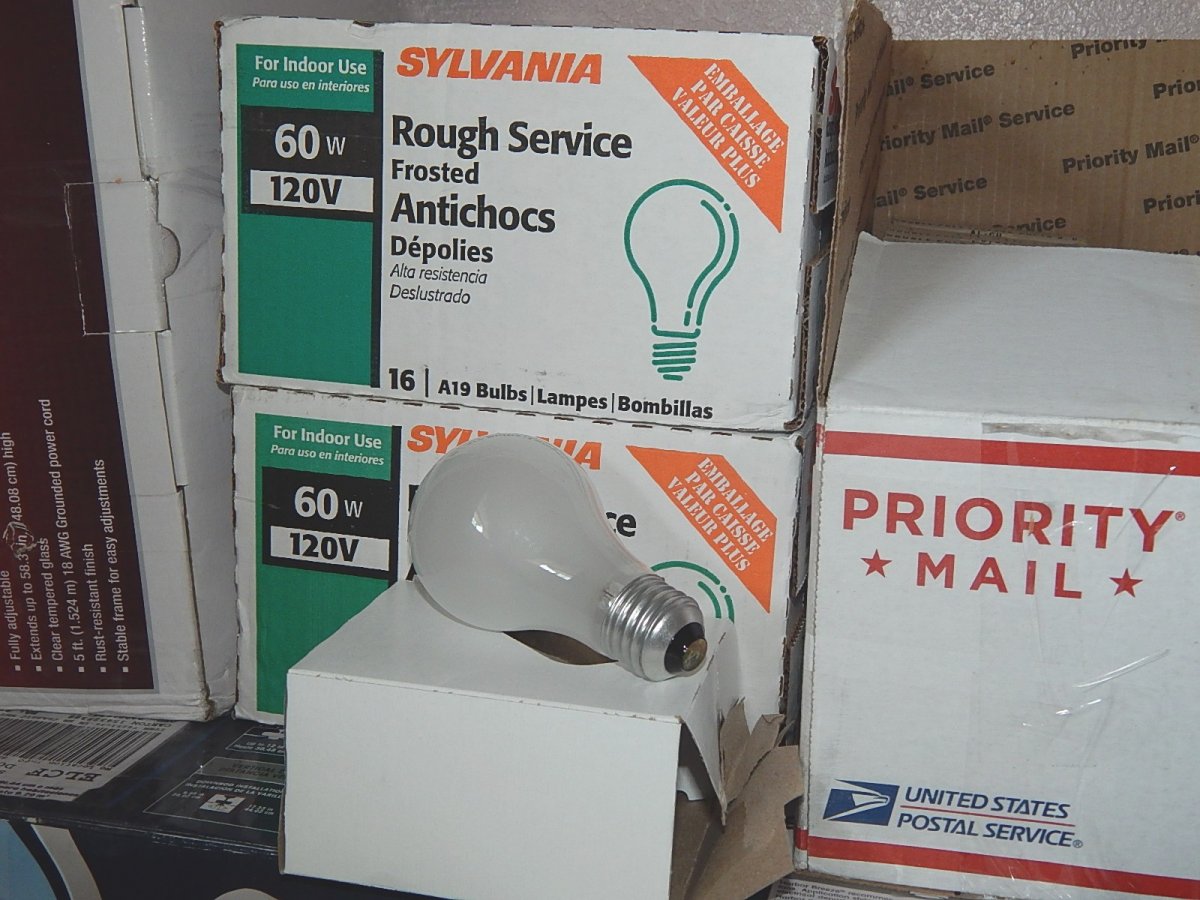

That and doing away with filament light bulbs.
