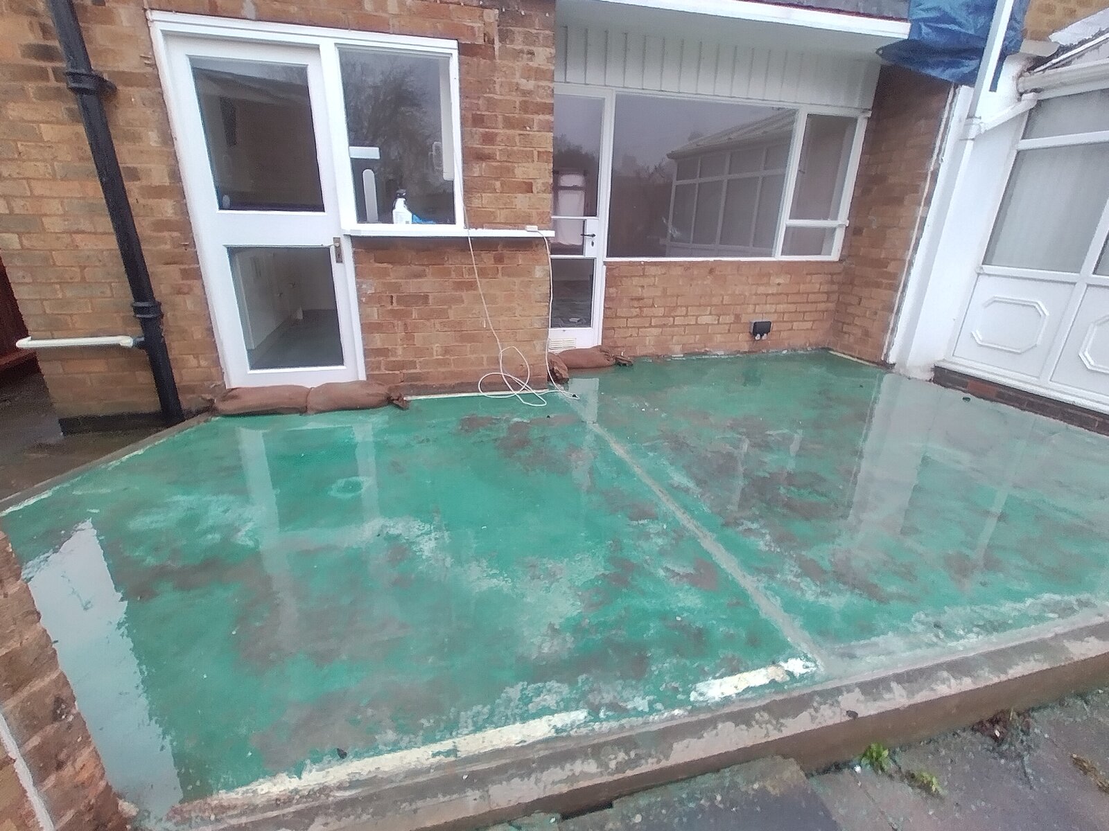

Old conservatory base built nearly to damp course
21 Nov 2023
90
5

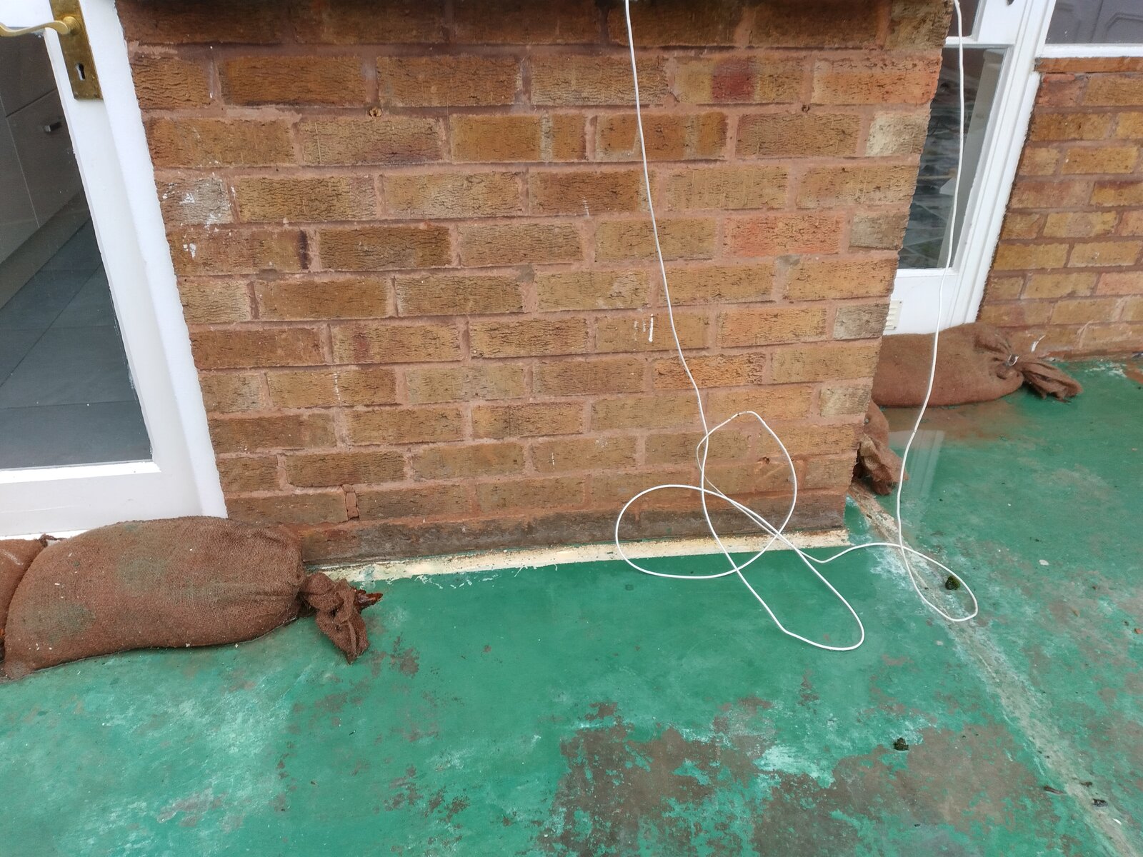

As mentioned within a thread on another subject, we have removed an old conservatory which was around 30 years old. We are now left with the concrete base and at present it is holding water when it raina which does pool up to the rear wall of the house. The base seems to be slightly lower on the right hand side on these images, as about an inch of the DPC can be seen above the base on the far right. Towards the left hand side of the base near the back door, the base seems to be flush with the DPC and no blue bricks can be seen above it.
An ACO rain drain set against the rear was suggested to me as a possible cost effective solution, running towards the downpipe which can be seen on the right.
Would this be acceptable and protect the house from potential damp?
In time ideally we may wish to have the whole base removed and paved but at the moment we may wish to keep the cost down as much as possible.
Thanks all.
Hmmm, by the time you have cut away the concrete next to the wall to fit the linier drain I think you will of solved the problem without the expense of putting buying the drain. But you will end up with a trench to step over. If the long term plan is to remove the concrete altogether then you are wasting money on the drain.
How about this for a cheap fix, buy some shed gutter and cut away enough concrete to accommodate it then cover the whole concrete area with decking including the bodge shed gutter. Or use the plastic click together tiles which you can remove for maintenance of the gutter.
Or just grind out a shallow drainage channel as close to the house as you can get an angle grinder in.

Thanks both. If I went down the cutting a channel route would it be an idea to fill up a bit with gravel for aesthetics and to avoid a step?
And would it be advised to reduce the height of any gravel from the current concrete height to protect the damp proof course which the current slab is pretty close to?

I reckon this is the answer
Just cut a channel with a mini grinder and a diamond disc. And then an SDS with rooftop drill to break out the bit in the middle
If it was 100mm away from the house that might be best as you wouldn't be channelling all the water against the house.
You don't need a big channel, 50mm wide x says 35mm deep would do. Leave it empty and keep it swept clear of leaves
Bear in mind until you remove the base, your house wall will suffer a bit from rain splash
I think an angle grinder with diamond blade and cut a simple V will save any extra chisleing.

Getting rid of most of the concrete shouldn't be too much of a problem it would be more cutting a straight line against the old brick work to reveal the old DPC rear wall of the house again which might be difficult.
Would it be a case of angle grinding a line against the wall?
I was thinking grind a slot, say, 200mm from the house, then use a breaker to smash it away and shovel it out to form a drainage and ventilation trench.
Cobbles or pebbles are better than gravel, the gaps are bigger so they drain better and have negligible capillarity.. leaving it open is better still.
