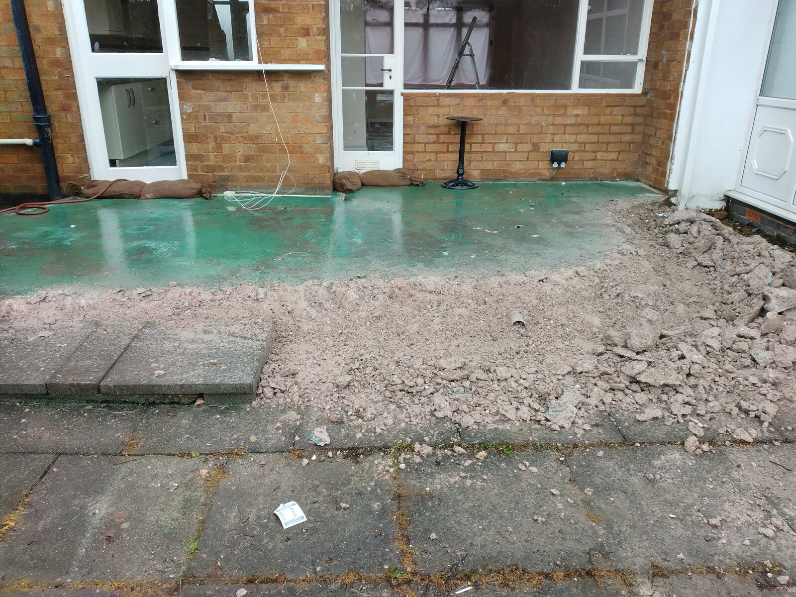

So far after 3 and a half hours yesterday afternoon with the heavy duty breaker.

Bit harsh imo never done anything like this before or used a breaker I'm unlikely to remove it alone in a day or half a day. The thing is rock solid with shingle and there's already two piles of rubble out of shot so keep having to stop to re shovel bits away.
Laid on paving slabs, and bridging the DPC?
I spy an air brick as well.
A particularly shoddy job.
You might want to dig round drains and gullies to see which are cracked and leaking.

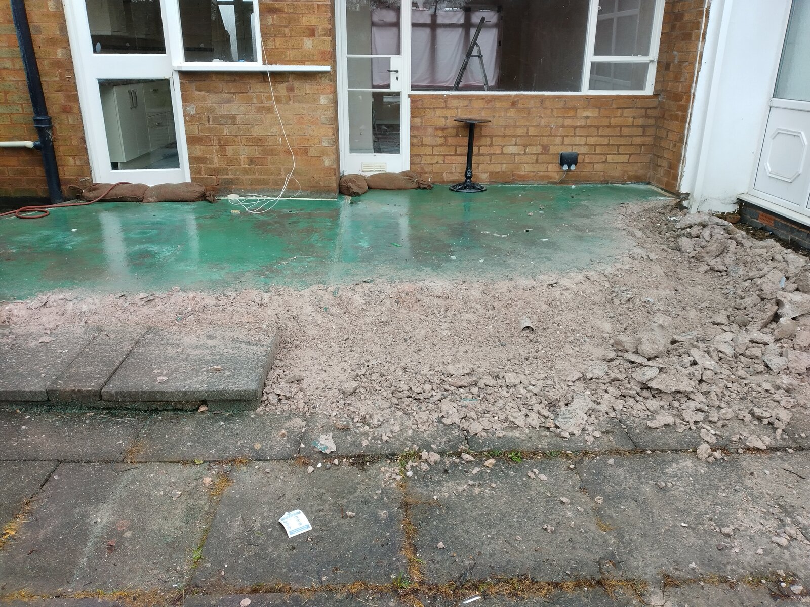

Made more progress on removing the base today.
Switched to the sharp tool (for the heavy duty breaker) and generally it does seem more effective. Although in places the concrete containing shingle is literally so hard that the breaker just drills a deep chisel shaped hole in it without it cracking.
Can anyone advise which bit fitting for the breaker will be best when I get close to the house?
Also could the vibrations of the breaker affect the rear house wall when I get near or will it only impact the concrete slab which the breaker is in contact with?
Have only been up near the house wall in one tiny area so far and to be fair the concrete did seem to just drop away fairly neatly.
I wonder if you can crack it and wedge it up off the paving slabs? A pickaxe could do that, I don't know about your breaker.
