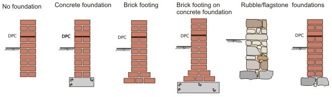

So is the key that if the trowel goes under them then they can be removed? If it won't they should stay? The house is from the 60s and canals not too far away.
I managed to find this pic showing brick footings. As you see, the wall gets wider as it goes down, typically twice or more width as the wall above, to spread the load.
Shoddy shallow footings are often found in Victorian houses, but if yours was built in the 1960's I think it is most unlikely to have shallow brick footings, and I was mistaken in my earlier view.
Hopfully its just another sign of the rubbish builder laying down a row of random bricks against the house, good because it means there will not be a load of concrete stuck against your blue bricks when you remove them.
As there's nothing on top of them they're definitely not holding anything up so are not part of a brick footing.
Have look under one, flick it out and have a dig down in that area. You'll probably find that the foundation continues vertically downwards way beyond these bricks so they were just part of some sort of garden feature or paving.
But still be careful, don't either force them into the house or prise between the house and them. You want to clear beyond them then lift them out.

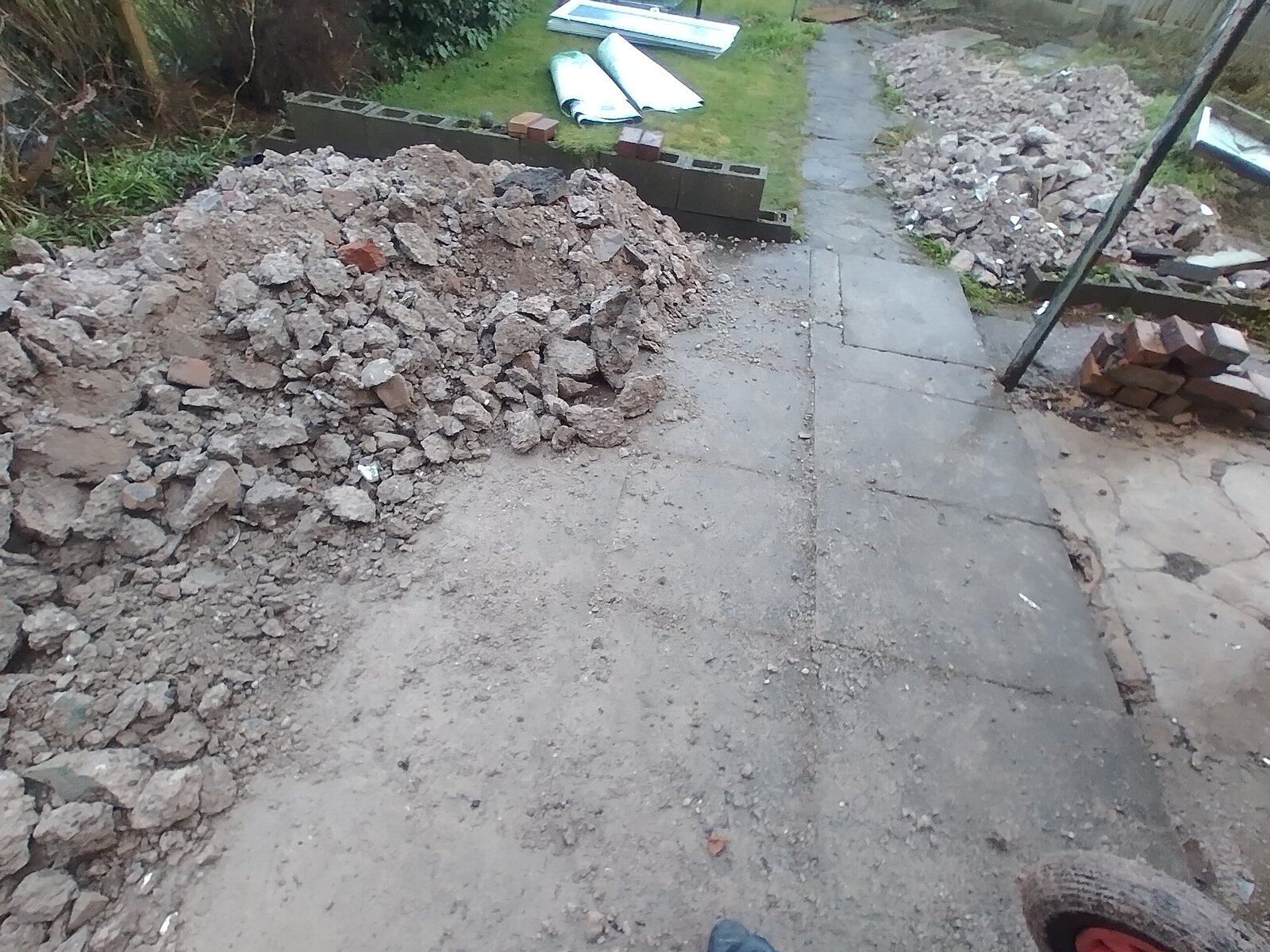

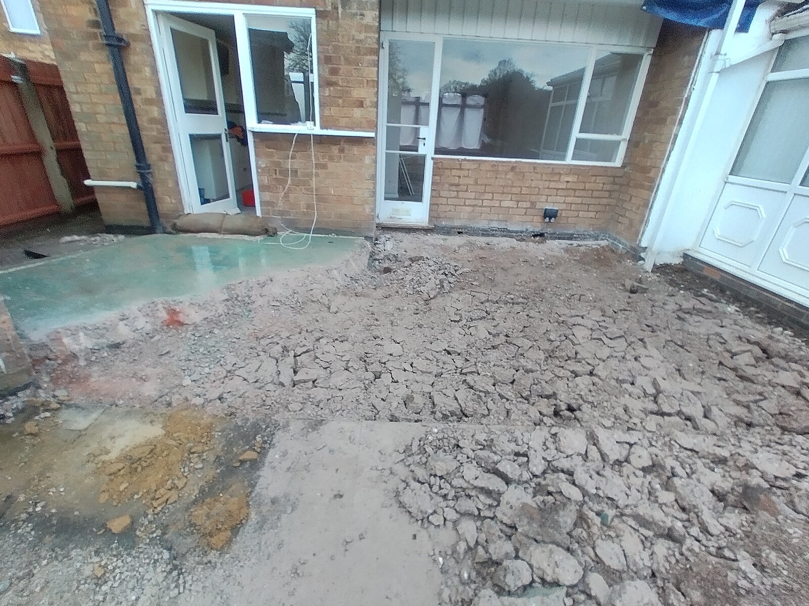

Today's work. And just to show how much we (well, some help from the other half anyway) have shovelled by hand...!
What we originally thought were paving slabs laid under this base has in fact turned out to be....you guessed it.....another base underneath of more concrete. This concrete though is about 100mm in depth and has just very fine shingle within it so the whole of the part that I have broken up on the right took only about 30 mins. Compared to 4 days and counting on the depth of the main base.
Breaker back now and due to other commitments I hope to be back on the job on the days between Christmas and New year.
As for the rubble, we have been given the details of a local skip hire firm who allow full loads of rubble to be dropped from vans or tipper trucks for £10 per load.

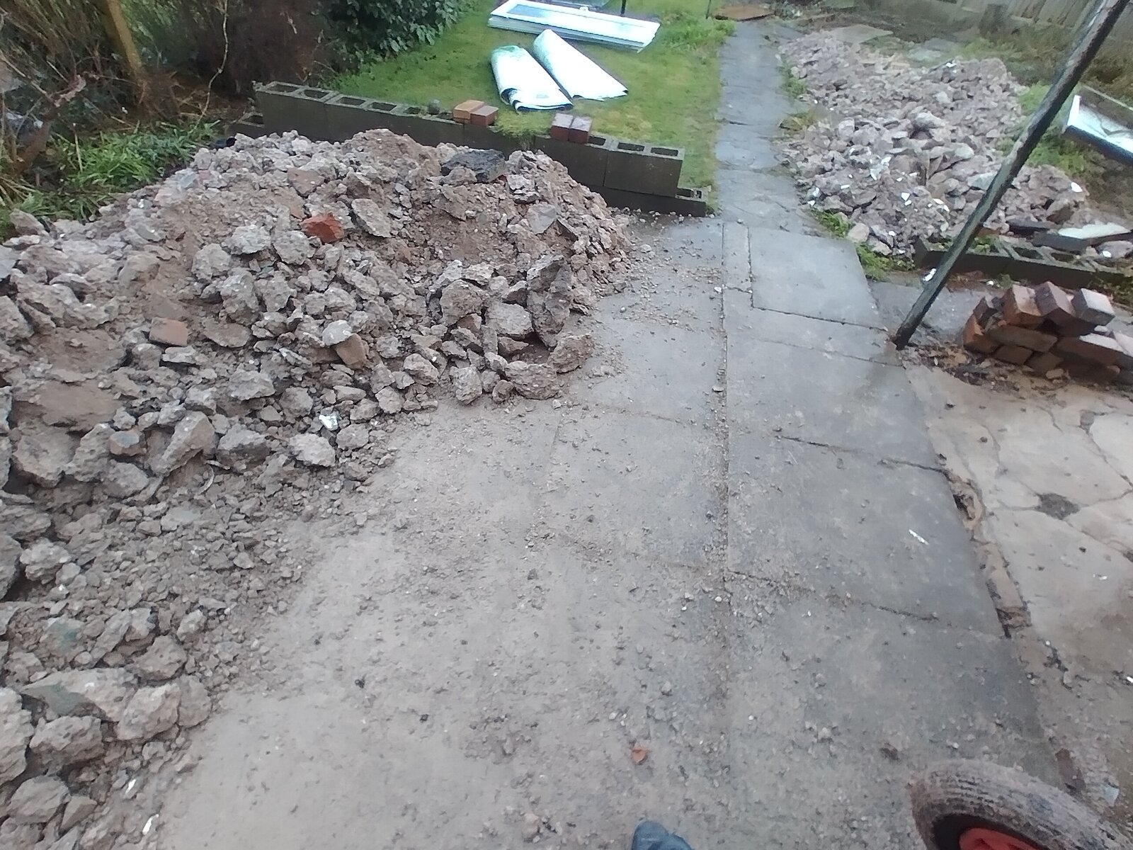

You are going to handle that lot twice or more? Some nutter has even put the hard core on soft ground. Going to be a nightmare shovelling off that.
Bonkers.

There is a shovel and shift it type bloke who does garden clearances etc who loads and unloads stuff like this everyday and tips at the skip place. Was given details today by another trade. The estimate we have is £160 so I assume that is not bad and we wouldn't have to handle again.
What's done is done anyway, it was stopping us moving on with new windows and doors with that concrete touching the old frames and water coming in without the sand bags.
I personally believe that if we'd employed builders they probably would have wanted a mini digger and two of them over 3 days and a skip.
As yet we are at discount breaker hire plus estimate £160 for a shovel and shift it.
