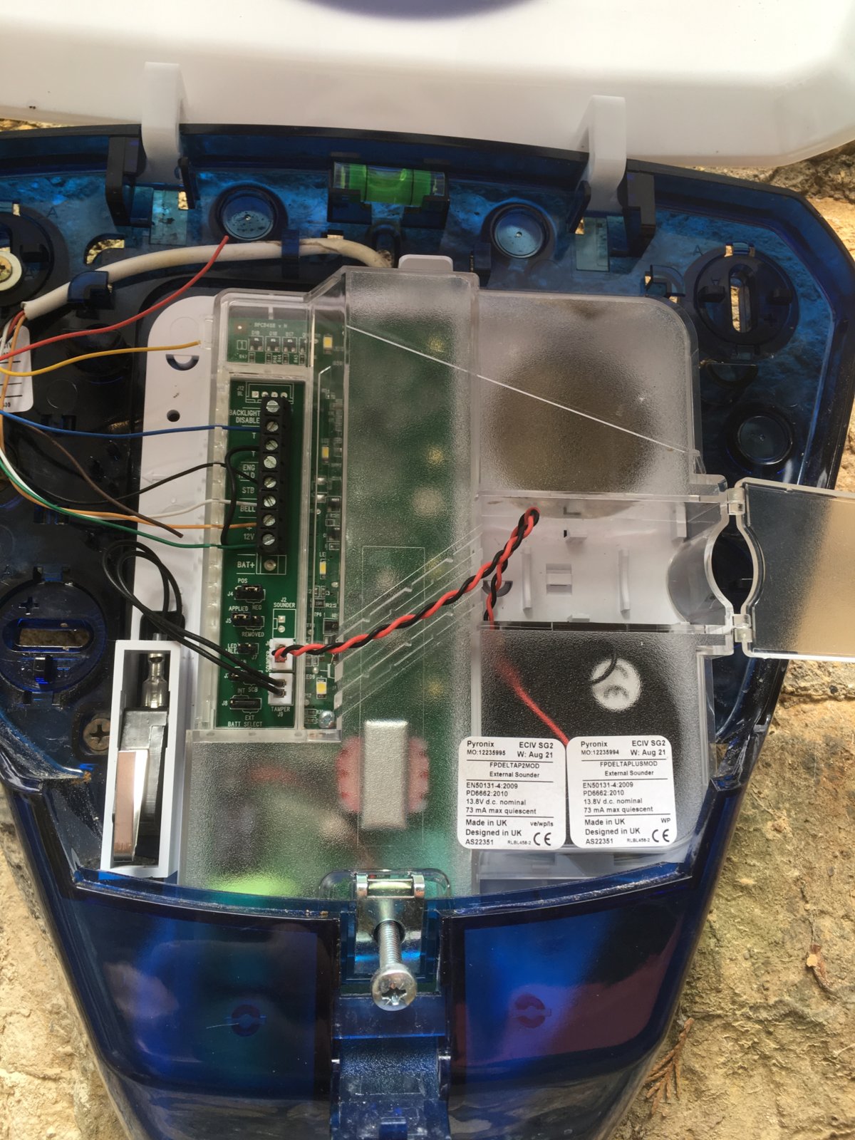

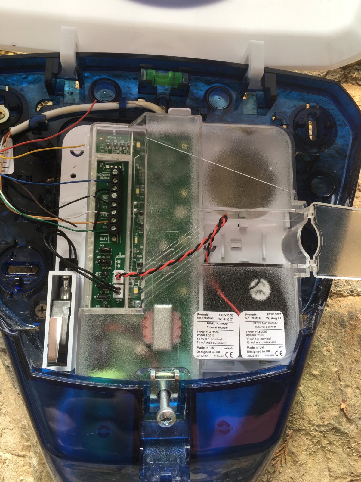

So I took the bell box cover of today see attached photo and the tamper switch inside the bell box didn’t even activate the siren..is it possible I have a faulty bell box ?
I remember reading that the bell box comes preset, so when it’s first gets power it won’t sound the siren...could it need a jumper moving or taken out of a start up mode ?
It seems odd that the bell box tamper switch doesn’t set it off as I thought it’s designed to run independently of everything as long as the bell box battery is charged ?

tamper not adjusted properly for the wall its on.
yes I set the tamper up with the adjuster screw so when the lid is lifted you hear a click and the bell box starts flashing as well as the panel inside the house alarming just no bell box sound...

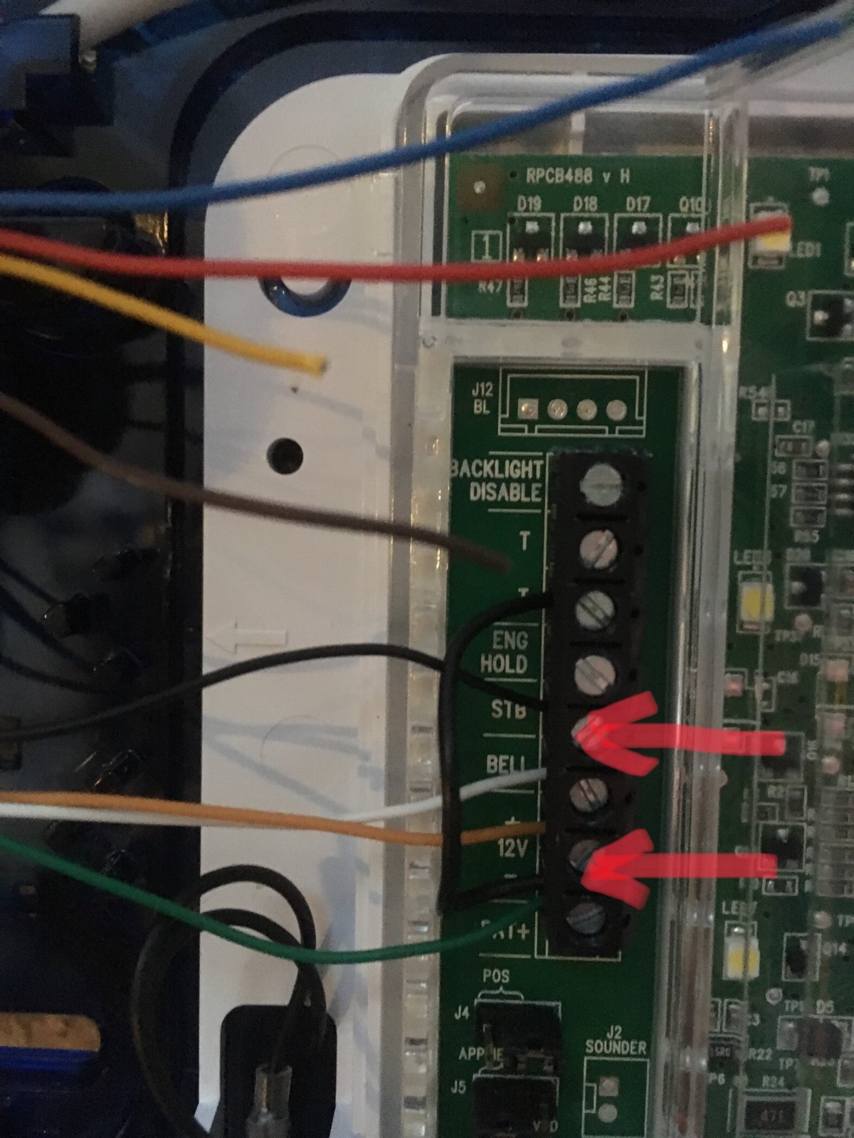

I've been reading a bit more and there are a few people with my model bell box with this issue and it seemed to be because the engineer hold wire was connected which seems to confuse it but checking my wiring that isn't connected...should I try adding it and if so any idea which wire ? or maybe it is a jumper I need to move as mentioned the alarm comes shipped deliberately not to sound the alarm the first time it is connected to power so maybe I need to reset something ?

In the bell box put a link from 0v to bell trip ....does the siren now work ?

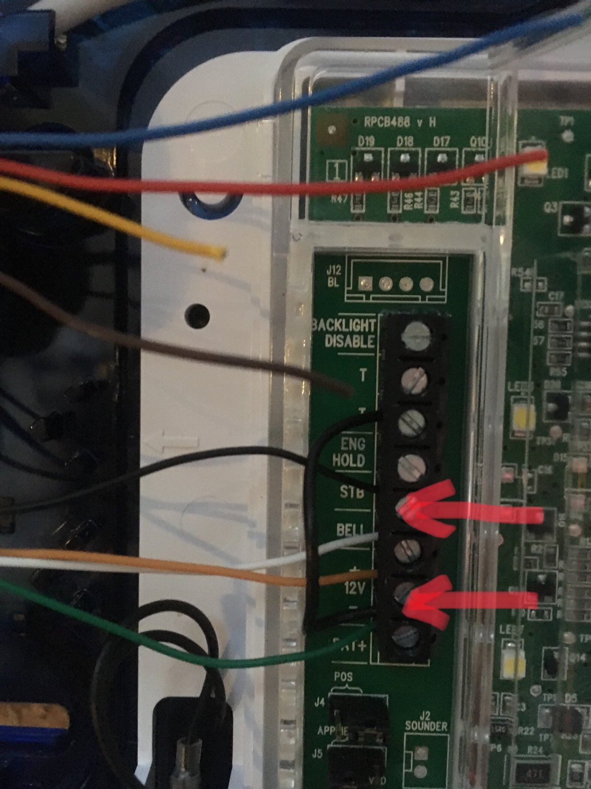

Sorry Sparky can you confirm you mean a link between these two wires, essentially -12v Green Wire and White Bell Wire ?
Sorry I just want to be sure

Unscrew that black link wire from T end in the bell box ....touch the bare end onto the bell terminal ( that has the white wire in ) it should ring ....now just to prove a point touch it on the strobe terminal ( black wire ) it should flash ....
Thanks Sparky sorry if I'm a bit slow, I ran the test and the piezo makes an almost inaudible siren noise it's sooo quiet but it is there ...you have to literally hold your ear to it to hear anything, when I then connected the 0v black wire to the Strobe terminal the lights on the bell box strobed.
I take it this is a bad sign and no way to fix it apart from replacing the piezo ?
