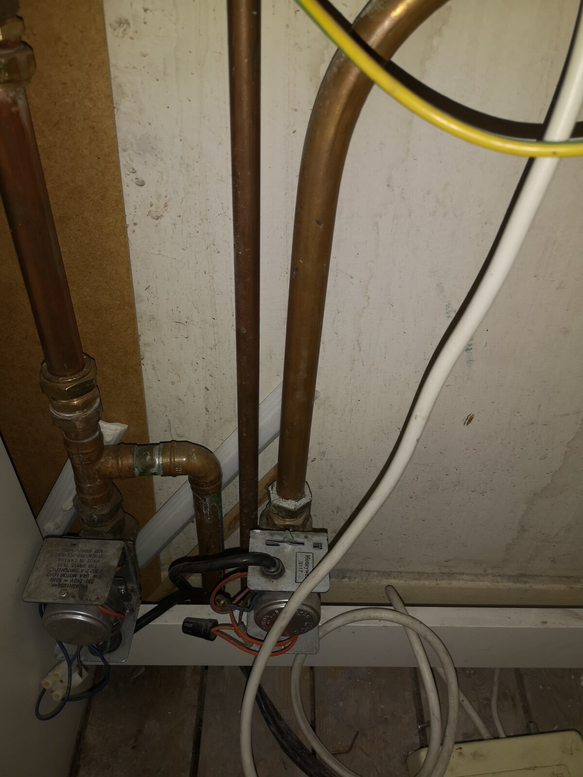

Also show us pics of pipework around the cylinder.

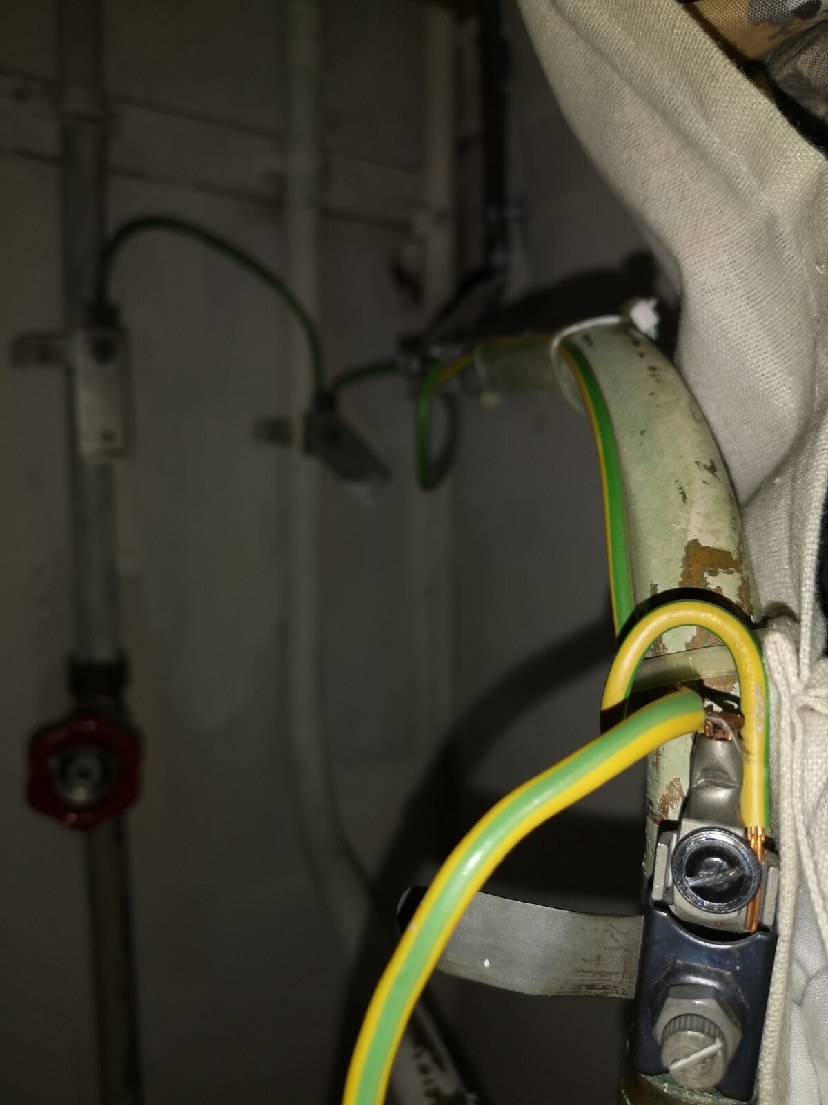

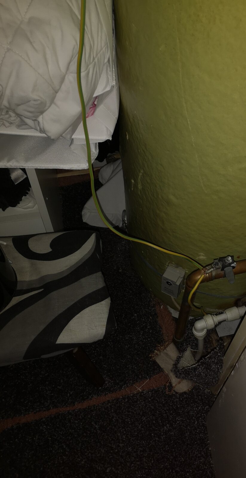

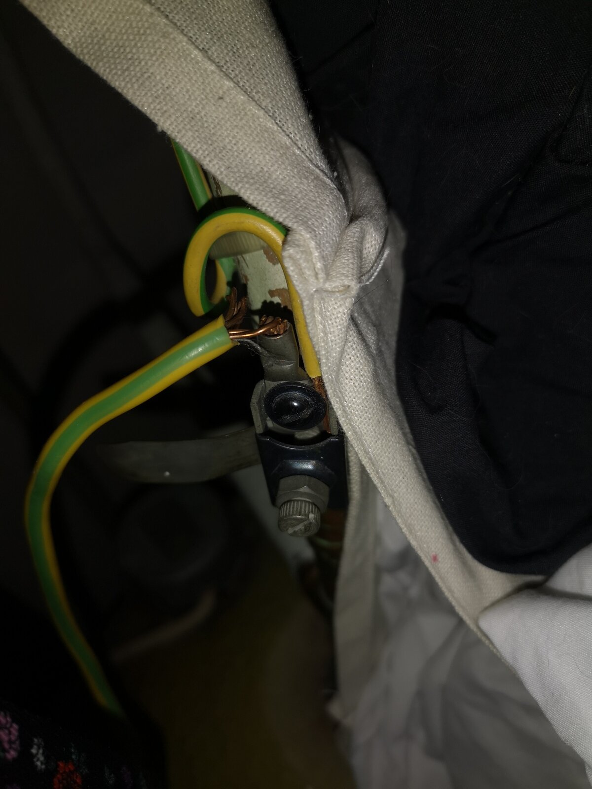

So first pic shows pipes coming into tank. The stopcock on left pipe appears to be gubbed but was also apparently gubbed before repair (when everything was working). Second pic is pipe coming from tank. White pipe was replaced when boiler went in (due to sludge in old pipe) and runs from tank on landing approx 3 metres to boiler in bedroom. Third pic gave me concern at first, earthing wire not fully connected, but as far as I can see there is enough locked in and it is only to earth...Am I correct?

The earth conductors need attention,and re connecting properly.
There are 2 motorised valves ,both missing covers, may or may not be working.

so primatic and its fully pumped (it can be done) where is your pump fitted ?
as for that 1/2 inch white plastic pipe in pic two are you saying that is the return out of the cylinder ?

The pump is at boiler (in bedroom) and the white pipe runs between boiler and tank and was put in when boiler was installed due to silt in previous pipe.
