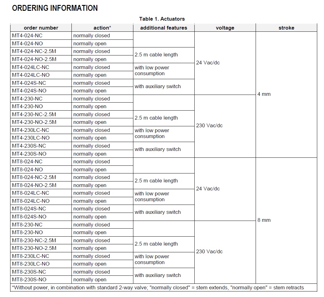

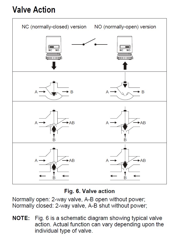

I meant to add that it isn't clear as to what the state of the switch is, it looks like the NC or NO suffix refers only to the state of the water valve.
This suggests that with a NC actuator the water valve is closed when no power and the switch is open. I assume that with power the actuator is pushed upwards to open the water valve and close the switch. The expamding wax drives the pin upwards. (( That is the opposite of a "normal" TRV where the expanding wax drives the pin down to close the water valve. ))
Bernard: I think you have got it. Thanks. The NC refers to the plumbing not to the electrics. I found some more info elsewhere which says you can wire the switches on several MT4's in parallel to control the boiler. That must mean they are normally open. Honeywell's response may well confirm this, but I have a feeling I just re-invented the wheel!
