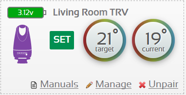

I fitted two electronic TRV heads which are wireless, there is however a problem, they don't seem to have a way to use the information given from the valves to work the boiler.
Shown is the report sent to my PC, it shows both target and current and if the target is higher than current on any valve then I want boiler to run, simple, however there does not seem to be any software to take the information and operate a simple on/off relay to do what I want, the relay is made, and the system is there, it uses IFTTT protocol however one you need some one to have written the program, and two it needs internet connections to work, so internet down would mean no heating.
So I would say the hard wired version does have a lot of advantages, however as to cost not so sure, EvoHome will do the job all ready set up, so unless cheaper than EvoHome not worth it, however EvoHome is expensive.
