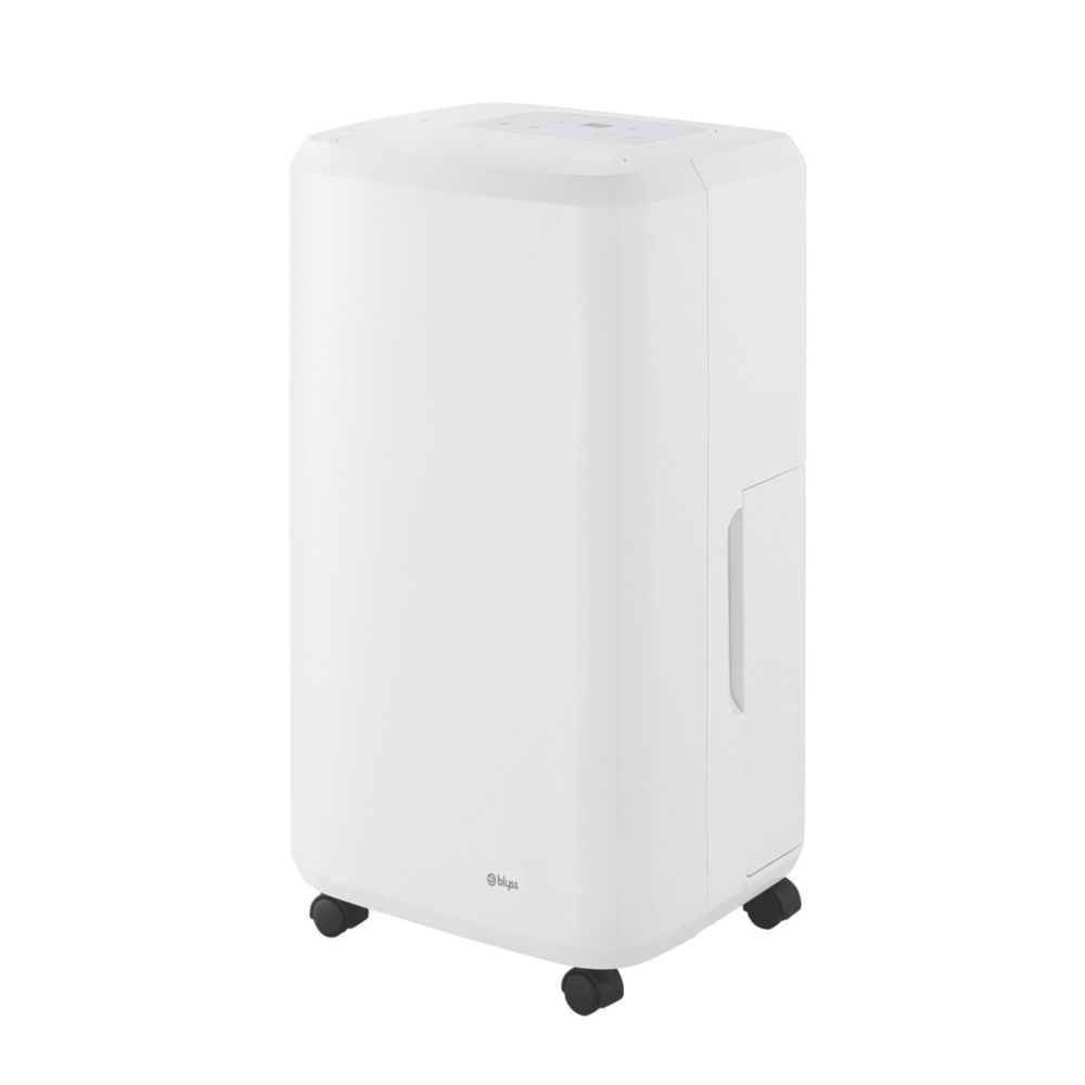

Evening/ morning!
Would like to run a dehumidifier in a no mains electric environment. This must be a common theme on new build building sites where dampness has occured before mains electric has been fitted right?
An example of one I could buy can be found hear
In the specifications it states its power output is 300W
I have a 110 amp AGM battery. Now I only have a 150W "Ring" invertor as you can see hear
In the specifications section it says its peak output is 300W (double its max power ratting). Will this do the job? or do I need bigger like the 300W vesion found hear
I think the invertors trip out at something like 11 volts. So my question is how long do you think 110amp battery will last before it trips out. The power out put of the dehumidifier says 300W; but is that only on start up or constant run? How much of my batteries 110amp capacity will be left when it drops to say 11 volts when my invertor switches off?
Short answer - unlikely to work and even if it did, site dampness is mostly a problem when the building is not airtight.
Even if it did work (with your bigger inverter) you'll get at most 3 hrs runtime from your 110aH (at 12v) battery. Most dehumidifiers work by cooling the input air so water condenses- this takes lots of energy, the 300w is likely to be continuous (and sounds very low to be honest).

There are two types of dehumidifier, one has a rotating ring of a moisture absorbent substance, and a heater and air is blown through the disc to dry it out, with in and out pipes, and the other ports have the dry air in and out, so 4 large pipes. These have very little in rush on switch on, and no refrigeration unit.
The other does use a refrigeration unit, it cools the air so moisture drops out and then heats it up again. The heat pump tumble drier works like this, and it has a minimum temperature it can work in. This it how the one linked to works.
Single phase refrigeration units need to start when there is no pressure in the system, so start time is critical, too fast and inrush is too high, and too low and pressure builds up before it has started, not such a problem with three phase units, which can use an inverter to control the start so domestic upright freezers are like this now, but that is expensive, so in the main a freezer which likely uses 60 watt running, will use 1000 watt to start.
The dehumidifier you like to is cheap, so one can expect a start load of around 10 amp, this can cause problems with some generators as when over loaded the field can collapse, so would likely need at least a 5 kVA generator to power it. Which is why on building sites the other type is used. But in the main they use inferred heaters and leave the windows wide open.

But your idea is a non starter, an inverter will never run a dehumidifier of that type unless rather large, mine as I said before is powered but a battery which can discharge at 3 kW and charge at 2 kW with a 3.2 kWh capacity and the inverter can handle 5 kW, and it was darn expensive. And I use a 50 volt battery not 12 volt, so current is a lot less. Also not lead acid.
Whatever it is you're trying to do, if your power source is 12V then you should be looking at things that are natively 12V rather than inverting to 230V. A quick google suggests that they do exist.

If you really must do that, or want to run other similar items then forget about lead acid batteries. They are low capacity and only last a few 100 charge/discharge cycles at best.
It's a generator or Li-ion batteries for any realistic setup.

For drying out a flooded house you're looking at days not hours. Cheap domestic gennies aren't rated for 100% duty- in that world you are looking at proper silent diesel sets.
