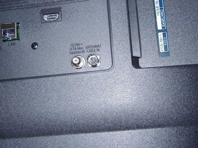

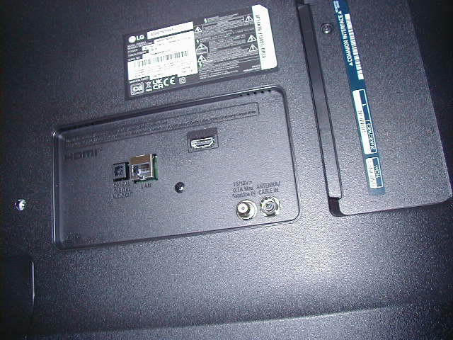

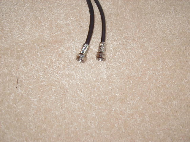

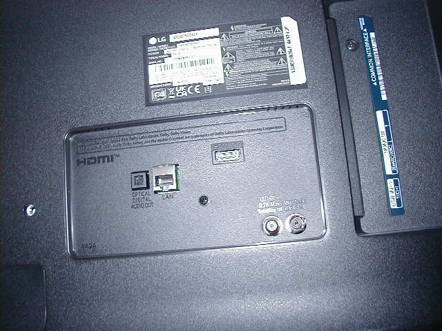

The cable from the dish to the TV has 2 wires, but only one of them has a fitting that screws into the back of the TV. The adjascent connector on the TV is of the push-in variety (like on a terrestial TV aeriel).

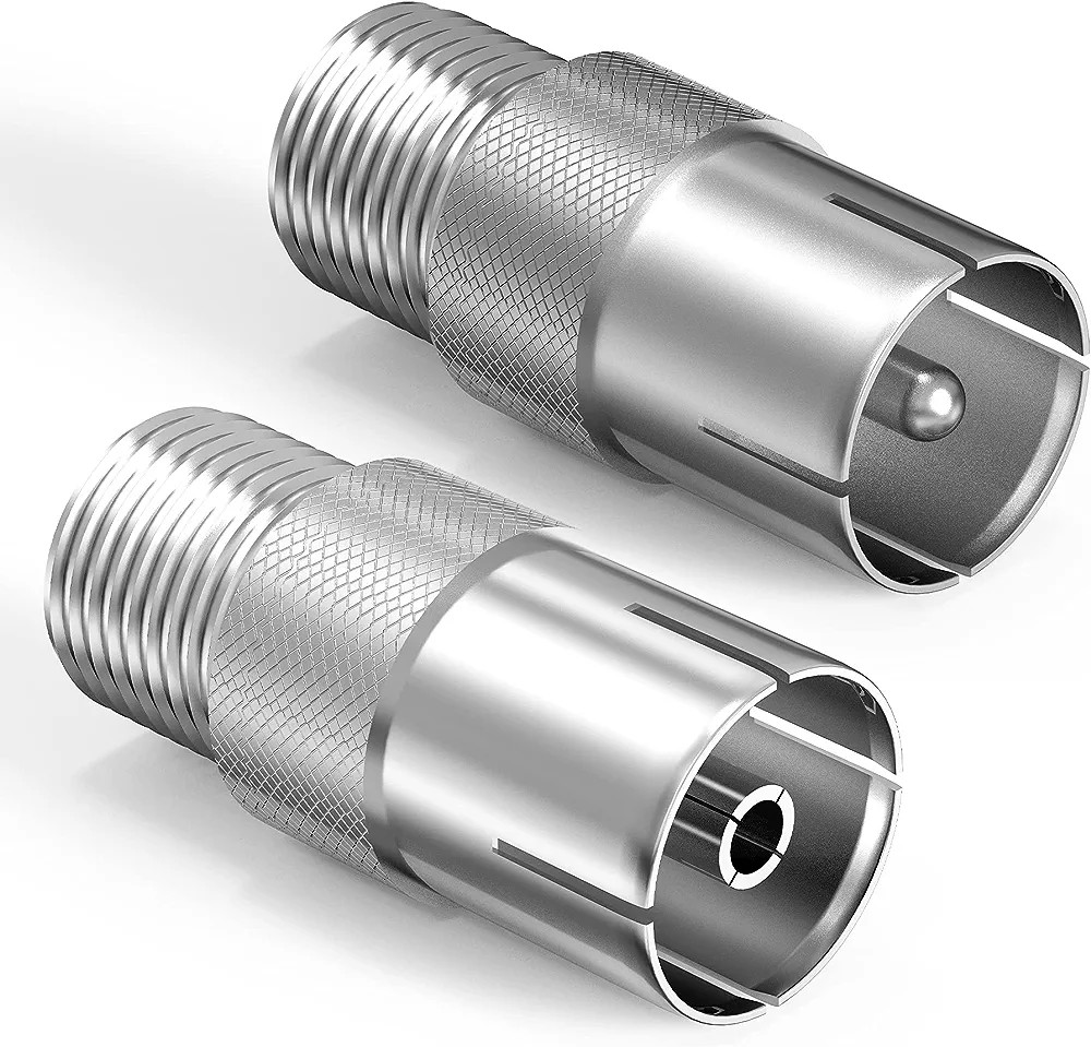

From the (very poor) picture, it appears that there is an adapter attached to the F connector - something like this...
This can be detached.
...although there is still no guarantee that the other cable will work!

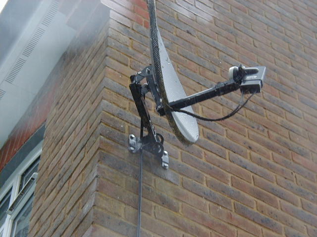

Dish may have a wideband LNB for Sky Q, which will not work for Freesat.

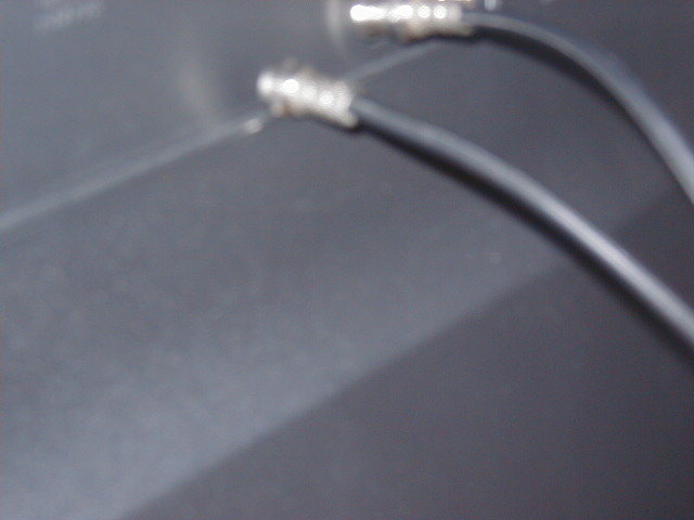

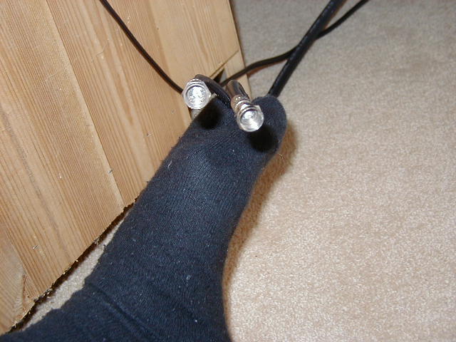

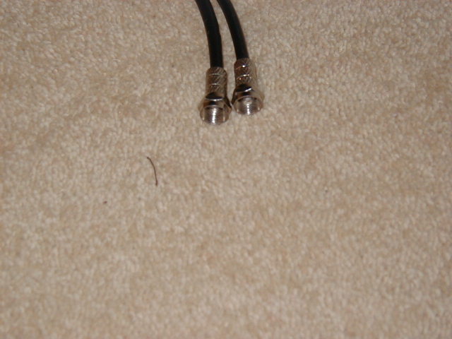

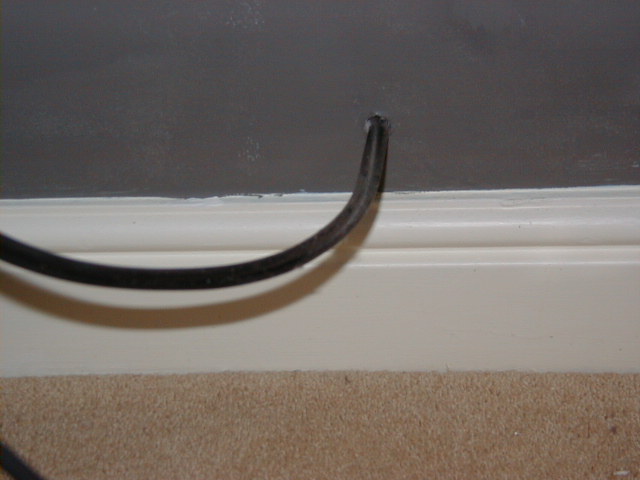

Those F-plugs are screw-on and I can't see any centre copper pin. If that's bent over or not inserted in the F-socket properly then no DC power will get to the LNB... The thin (4.5mm diameter) WF 65 shotgun cable is especially easy to bend over.
MUCH BETTER pics of the LNB (it has a label on the side with make/model) and the plugs (close up rather than from a distance)? But the cables vs LNB shield positions suggests a standard quad to me. Google Images for Sky Q LNB to see examples of Q wideband and hybrid and probably standard quads.

I disagree because of the location of the wires into the LNB... That's typical of how $ky technicians connect to the older quad LNB with 4 inline connectors. (More modern ones have the 4 side by side). $ky Q wideband LNBs have only two connections and in side by side form. Hybrids are different but usually distinctive and the two Q wideband sockets are close together, not apart as in the photo.
$ky Q wideband LNBs don't work properly but there have been reports of something received.
I strongly suspect a connection issue and a remake of one or both F-plugs would be my starting point.
NB The OP's TV set is likely not freesat as the first thing on a freesat tune a need to input a postcode (and for reception of the freesat 'home transponder' to use that code input to set region/nation to use). It has one sat input (the F-socket/screw in) and the other is for a UHF TV aerial.

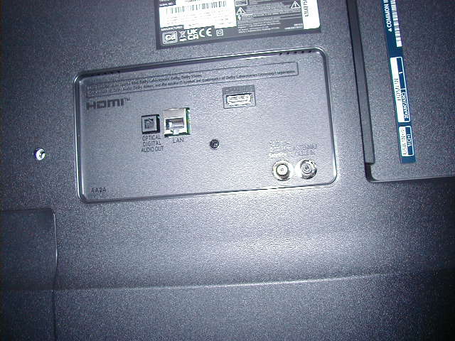

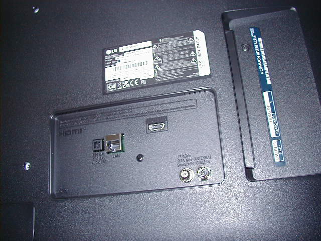

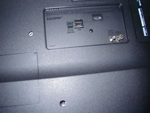

TV is LG 43UQ75006LF from John Lewis. Link:
described as
Digital tuner Freeview HD and freesat HD
I specifically them about freesat as I knew the new house had no terrestial reception. so no freeview.

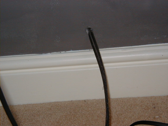

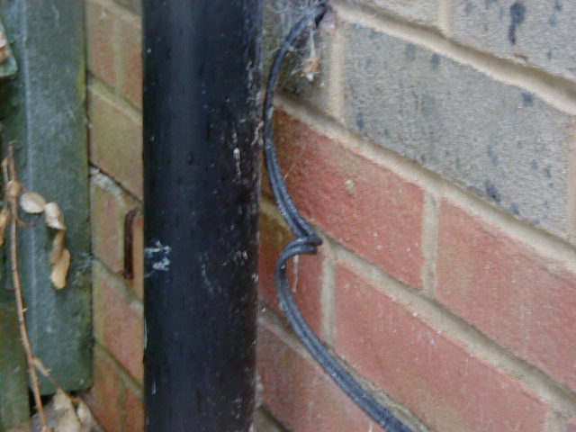

The LNB on the dish has a figure of 8 aka shotgun cable (two cables joined as one) split apart to the two (out of 4) sockets on said LNB. That shotgun cable goes through the hole in the wall into the house and is split apart a bit and terminated with two F-plugs. Both cables are for satellite.

The markings near the TV F-socket will likely state what it is for (but is unreadable in the picture provided). I'm certain the TV has a satellite tuner as the OP has found the satellite installation screen.
