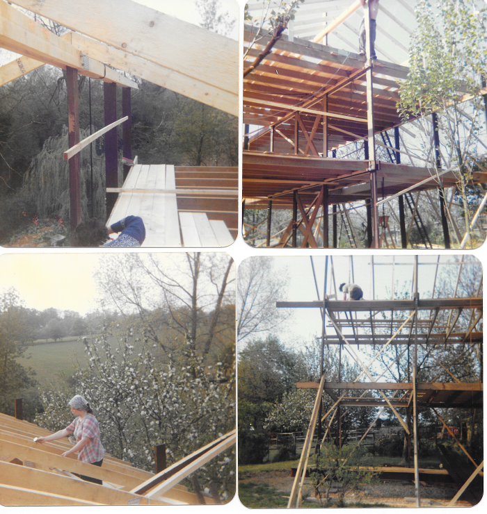

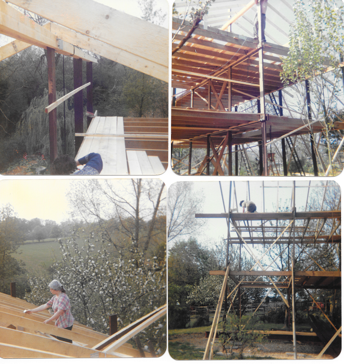

I've noticed that there are these timber framed flats that have been assembled and haven't got true structural walls.
Someone was trying to explain but I didn't know you could build wooden framed buildings without structural walls
Look at https://www.sips.org/
Structural Insulated Panel System
They are NOT framed buildings.
This is a framed building
