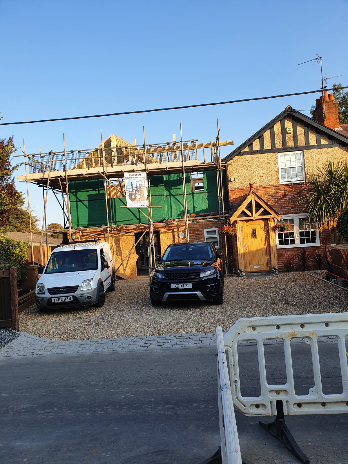

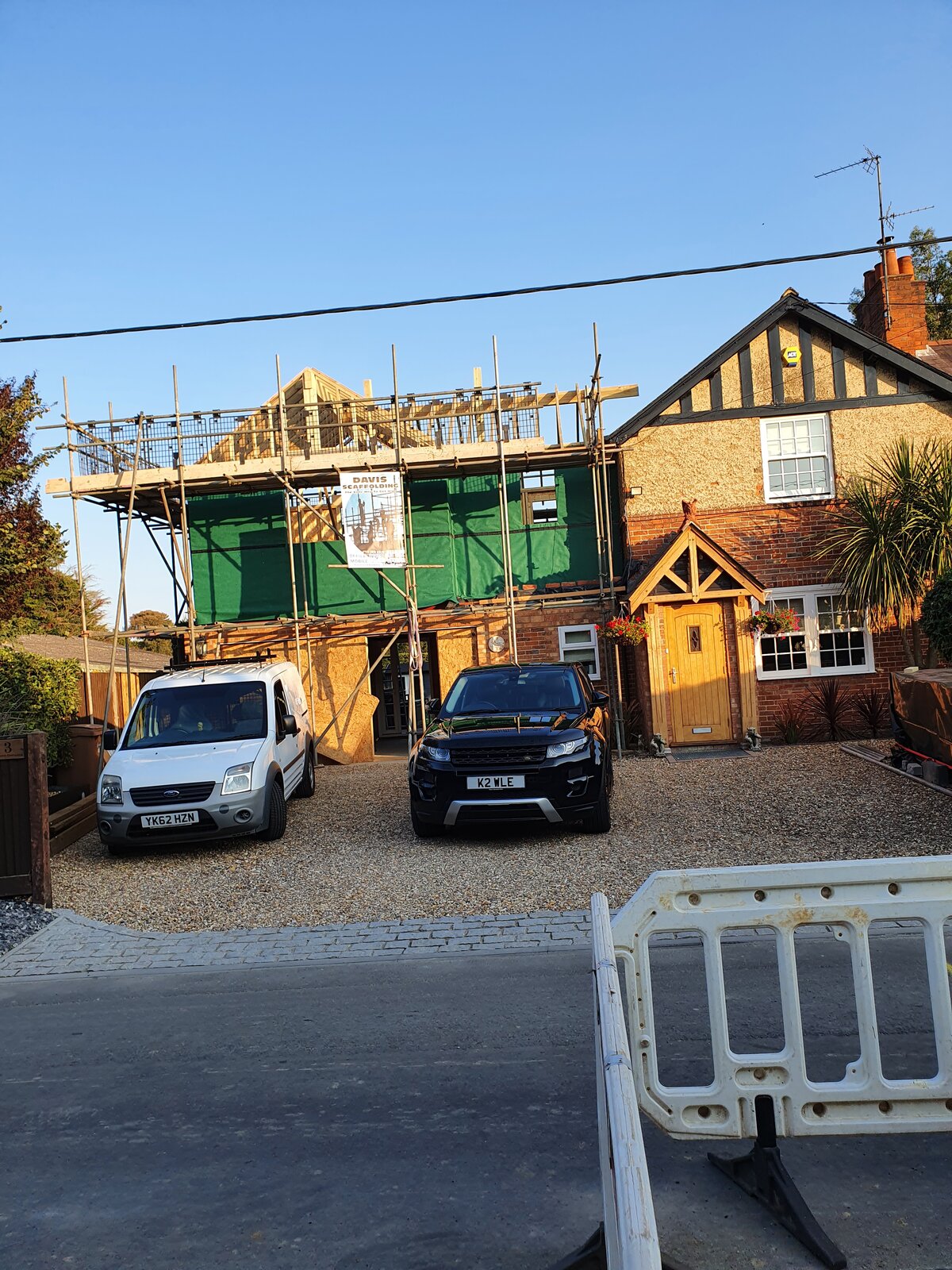

Plus one here doing timber frame on mine at mo

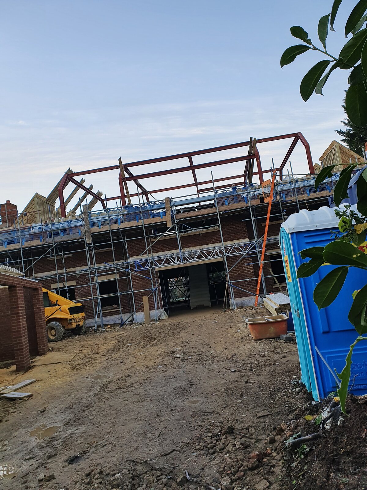

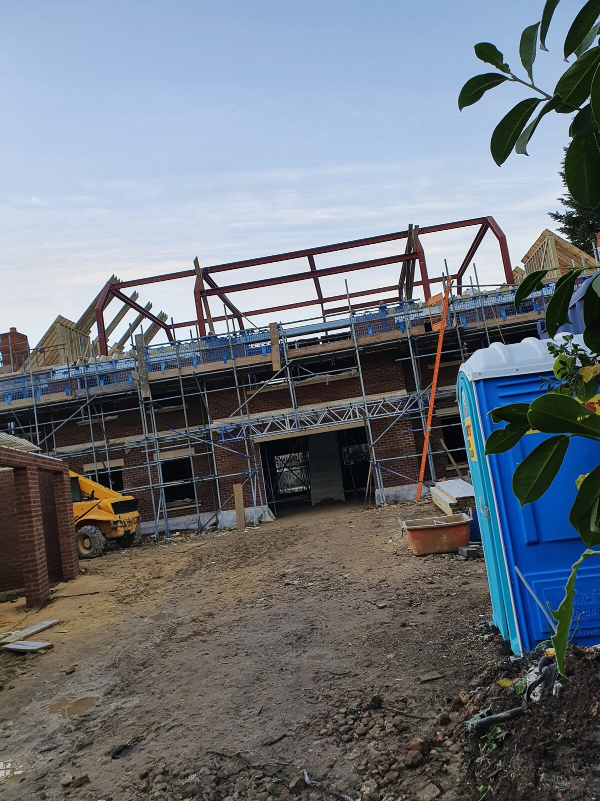

And a trad house with part timber part steel frame why I don't know should of had concrete floor blockwork then roof

So that's the timber frame. What are the solid sheets that are directly behind the brick skin? Is that insulation or a load bearing wooden wall of some kind of material/panel? Is the house to the right traditionally built and then you're extending that? It looks like it's progressing nicely. How much quicker is it building that one than if you'd built it traditionally and what made you choose the timber framed option if you don't mind me asking? It's going to be grand when it's finished!
The solid sheet is usually OSB, and is part of the structural strength of the panel. In my 1995 house, from inside, you had...
Plasterboard
Vapour barrier (stop vapour from inside rotting the frame)
6"x2" Frame filled with 6" of rockwool insulation (Not the norm back then, usually 4")
OSB Panel
Breather paper (the green stuff)
Then the exterior finish was wall tied to that.
