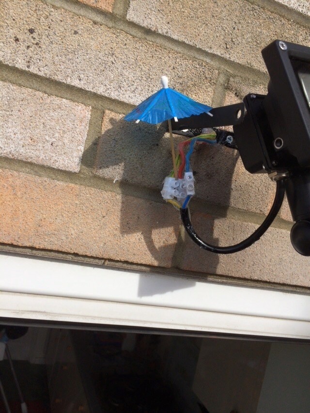

I've also seen stuff like this. Just because it exists, doesn't make it right
