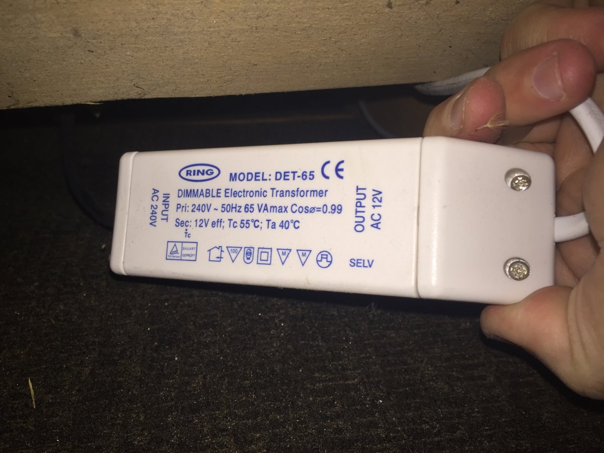

I am looking for a replacement for a lighting transformer that has packed in. I am struggling to find a replacement, just wondered if anyone could help. I have attached image of old one
Just don't buy anything of a make you've never heard of from a Chinese seller on eBay or Amazon.
What wattage and how many lamps is it running, 65va is a bit of an odd size and if you go for a higher va then the lamps your running possibly may not meet the minimum load requirement.
