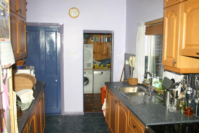

Utility room- special location?
hhmmm, interesting question.... ( to which i don't know the answer )
I suppose it may depend on the definition of what a kitchen is and how far that could be reasonable applied in a practical sense.
If it is just 'kitchen = place where food is prepared'
then if i ever sit in my front room and open a bag of crisps, does that then become a kitchen :)
dou you ever prepare food in there?
we sometimes use a microwave oven in there, when the kitchen sort of " overflows" It was just that with the room ahving a sink, water etc I would have thought it was the same as a kitchen as far as the electrics where concerned. After all what is so special about food preparation? I use a gas cooker !!
I have no idea what is so special about food preparation, but it is important as far as the building regulations are concerned:
"...a room or part of a room which contains a sink and food preparation facilities..."
So, a utility room with a sink is NOT a kitchen if you don't prepare food in there. If this was the only area of the house that could be construed as being used for food preparation, that may be a different matter, but you already have a kitchen next door. This is a utility room, so as far as I'm concerned, any work you carry out within it is not notifiable.
Of course, it's all open to your own interpretation of the regs, but I think it's highly unlikely you will ever find yourself in a situation where, having carried out the work, you will be forced to justify your reasons for not classing the room as a kitchen.
With a sink and water about personally i'd treat it as a special location even if food wasn't prepared in it.

I am going to add a few sockets and replace the light in there ( will I have to stop the new light from illuminating the kitchen :LOL: )
I wouldn't, I wouldn't even treat a kitchen as a special location.
Not to say that work in a kitchen isn't notifiable, it just isn't a special location.
