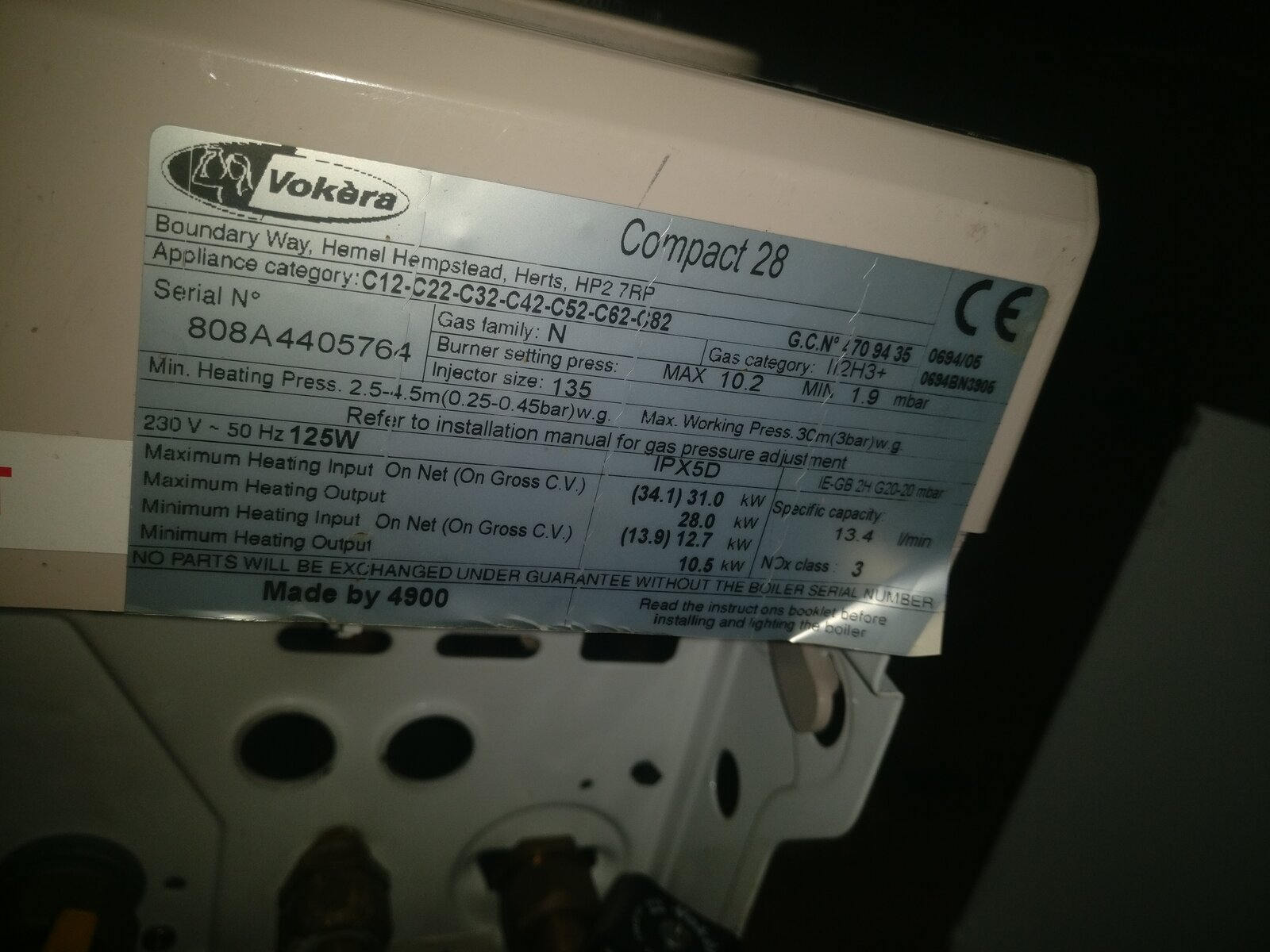

vokera compact 28
Ianmcd this is label on boiler
The plumber replaced the pump...did he replace the fan too?
He's working illegally and only registered engs. are permitted to work on boilers regardless of whether it's just a pump swap.
If you are going to drain it down to check hose/add more cleanser, disconnect and remove the isolation valves underneath (return and flow). Do not turn them off as they will leak, when the hoses are removed (or possibly pump being replaced) to clean a lot of crap falls into these valves and blocks them.
