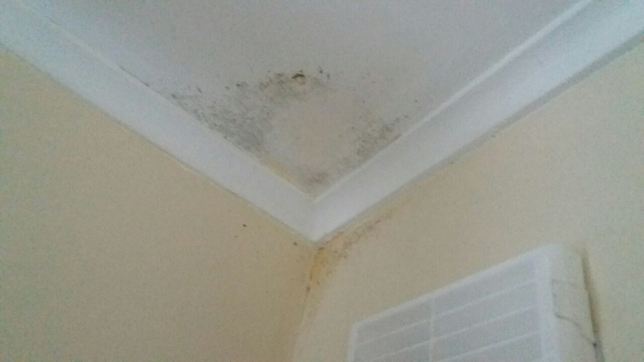

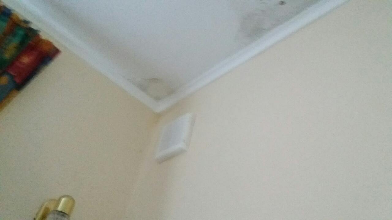

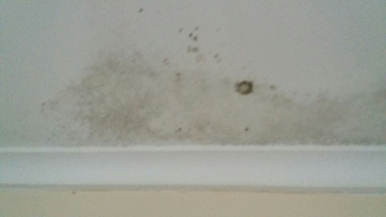

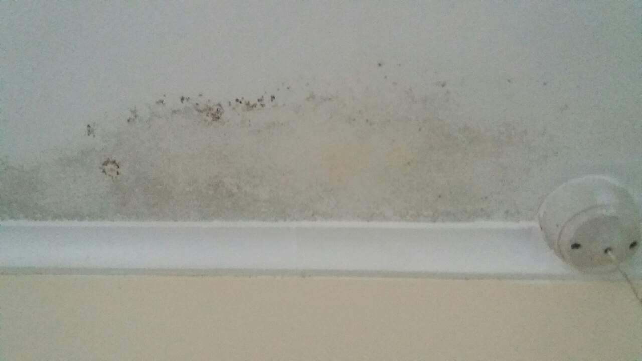

Two years ago after my mum died, I decided to hang on to her bungalow for my possible future retirement accommodation. Meanwhile I rented it out. Last year, the tenants reported a problem with damp behind a drawer unit in the bedroom.
Some of the neighbours reported that they had similar problems which they had resolved by fitting a air vent, so I arranged for this to be done. Through the summer all was well, but as soon as the cold weather arrived, more damp appeared, this time on the bedroom ceiling.
There was never a problem whilst my parents lived there from when the bungalow was built in 1980 until 2016. The tenants have been in touch and have asked me to do something about it. But I don't know what needs to be done, I don't think there is a building issue, or is there? can anyone offer advice please? The new air vent is visible in the photos.

I get similar damp below the eaves in 2 rooms. I suspect there's very little insulation above those parts, creating cold spots. So maybe lots of insulation in the loft, and some anti-mould paint might be enough to fix...
of course, the real cause of the damp could be not using extractor fans, leaving clothes to dry on rads or heated clothes rails etc.
Make sure there's at least a thin layer of insulation right at the edges. Probably the cold draughts in the loft on the plasterboard causing it.
Lots of insulation isn't important, just at least some everywhere. Consistency is more important than maximum quantity.
Also the usual about tents opening windows to ventilate, use cooker fan and bathroom fan, don't dry clothes in unvented rooms, keep everywhere heated properly on winter
Thanks guys that is pretty much what I thought. I wondered about the insulation. The walls are cavity insulated and the ceiling does have the insulation that was fitted in the 1980's when the property was built, and if I had to guess say that it looks to be somewhere around 6 inches. I thought about adding some additional insulation, but didn't because 1) The insulation has been there since 1980 and the problem hasn't occurred before, which I would have expected if inadequate and 2) the extra height would stop the airflow in the eves, which I understand should be avoided.
As I say don't add more height overall just make sure it's moremore ev spread. 2 inches everywhere is much safer than 12 inches mostly but none for the last 6 inches at the eaves. Look up thermal bridging for more info.
However as you rightly say the inside loft ventilation needs maintained.
would it be worth putting some insulation board on top of the ceiling board right into the eaves?
