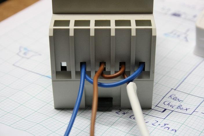

There we go, I've wired channel A in with the 'input' terminals, as well as the connection to the actual LED driver.
Danger of death out of 10?
WAIT.
You have not done it properly.
Which terminals are which?
All Neutrals should be together in the same terminal.
WAIT.
Cheers, EFL! How about this? Have I interpreted you correctly?
Left to Right:
1 2 3 4 5
2 = Channel A COM (LED Driver)
3 = Channel A NC (LED Driver)
4 = 240vAC Live
5 = 240vAC Neutral

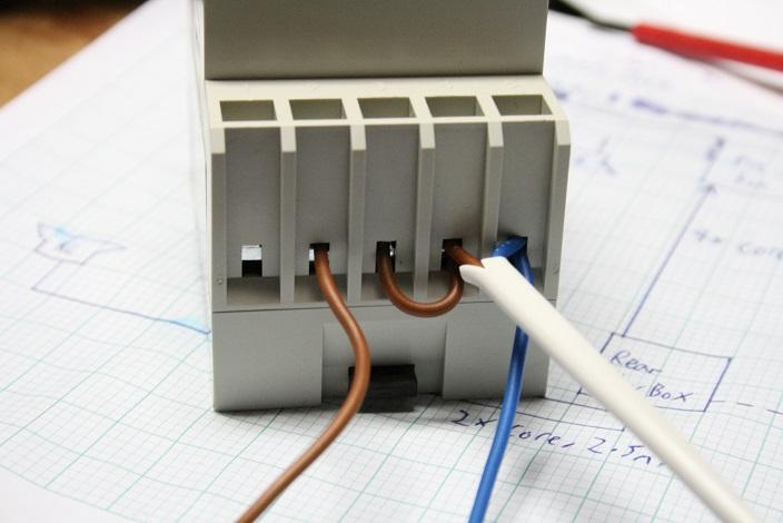

No you need to use the NO terminal '1' for the link.
If the white cable is 240V supply.
I wasn't sure, that's why I edited my post.
Thanks, EFL. And again for the patience - I've not worked with anything beyond a simple in-line switch before this!
Got my diagrams drawn up and feel confident that nothing is going to explode in my face. Time to break out the choc blocks!
Whilst correct, I feel you may be introducing confusion by swapping the connections, not to mention the blue 'loops'.
Think I've managed it, wired everything into a project box to test it before I go installing it inside the reptile's cabinet.
I've got the neutrals from both lighting systems going to a choc block which connects them directly to the plug's neutral prong, with the lives going through the timer (with both A and B getting their 240vAC live from terminal 4).
Going to test it out with nothing connected and my multimeter to make sure there are no unexpected electrical fires!
All done and functioning perfectly with no abnormalities! Time for a tidy up and a well-earned break, I think. Have just popped the project box into the cabinet for the time being - will hopefully be mounting the system properly tomorrow.
