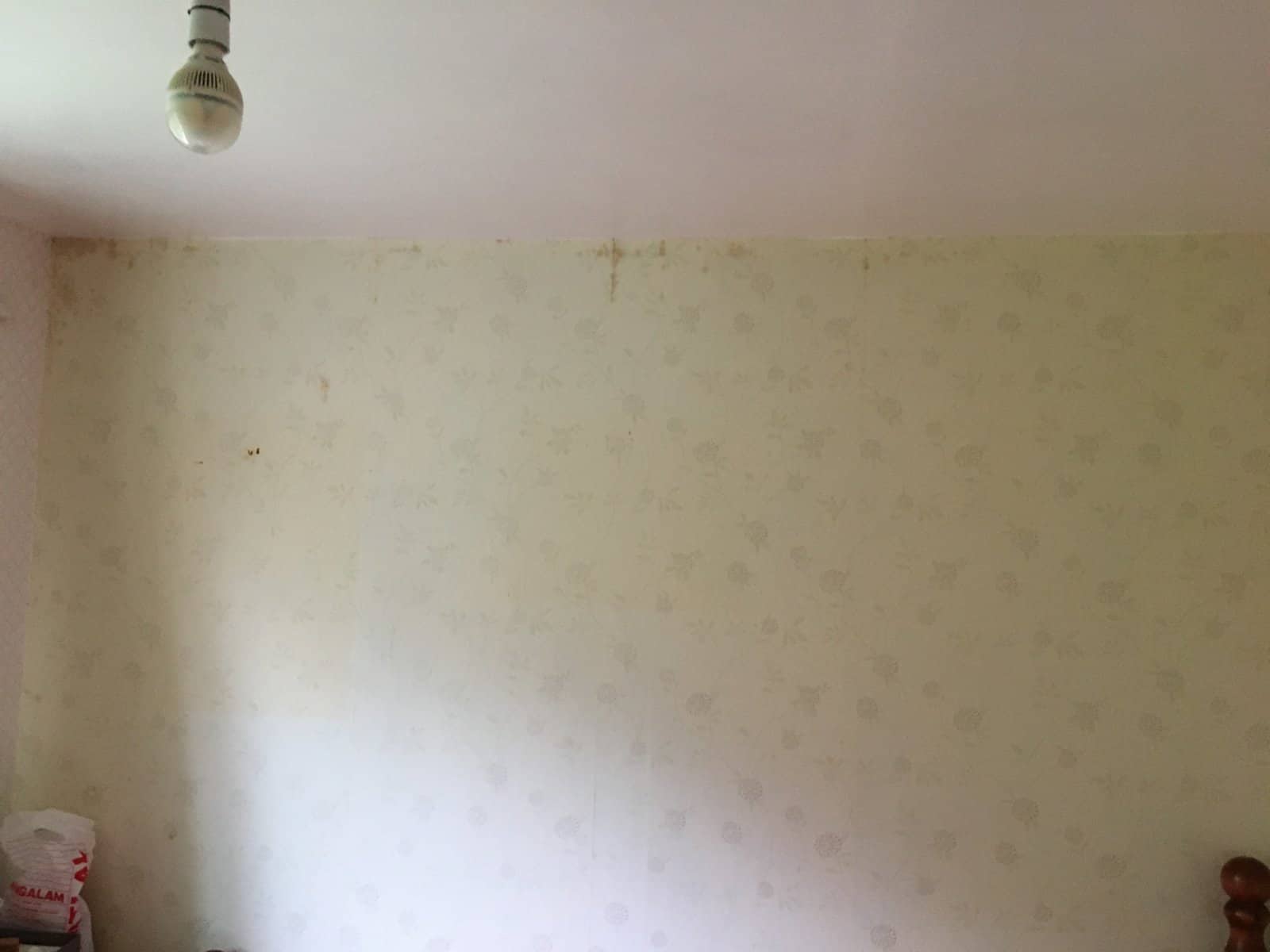

Water gets in, then it shows up somewhere else. If it is a leak, the staining concentrates near the wall/ceiling junction because that’s where water tracking down rafters or along the wall plate hits the top of the plaster. A clean cavity wall with no tie-line staining and sound pointing outside makes classic penetrating damp less likely. You’d normally see a more regular pattern following the wall ties or a defined damp ‘shadow’. Nine times out of ten, when the outside checks out and the loft is dry, you’re looking at either a roof detail that only leaks in driven rain, or a surface issue on the paper itself.

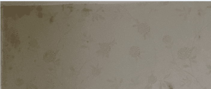

Close-up of cream floral wallpaper showing brown blotchy stains concentrated towards the upper left, with lighter isolated marks across the rest of the surface.
Brown, blotchy staining on wallpaper concentrated along the top of an external wall — a typical pattern for moisture-related problems in UK homes.

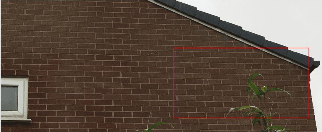

  • Check the roof verge and the tiles directly above. Binoculars from the garden are your friend. Slipped or cracked tiles, a lifted verge, missing pointing at the gable, or felt that doesn’t drop into the gutter properly will all let water in only when wind drives rain at a certain angle.

  • Strip a small test patch of wallpaper. If the plaster behind is dry and only lightly marked, and the brown is mostly on the paper itself, you’re looking at a paper/paste problem, not a structural damp problem.

If it’s a paper issue, the chain is different. Old paste left on the wall from previous papering jobs is organic. Add a cold external wall, a bit of humidity from normal living, and mould or bacteria start feeding on the paste. The by-products are brown and they migrate through the new paper from behind, showing as blotches. It looks alarming but the wall itself is sound.

External brick gable wall of a UK semi-detached house with a red rectangle highlighting the junction between the brickwork and the sloping roof line near the eaves.
The highlighted area shows the roof-to-wall junction on the external face — a common point for intermittent water ingress even when the brickwork itself appears sound.

Better (if there’s a suspect roof detail but no obvious failure): Do the above inside, but also get someone up a ladder to lift the tiles along the verge and the courses above the stained area. Check the felt drops into the gutter, the verge is bedded or clipped properly, and there are no cracked tiles or failed mortar. Redress anything marginal while you’re up there. Cheap insurance.

Interior view of an upstairs bedroom showing cream floral wallpaper with brown staining running in a band along the top of the external wall, fading towards the lower sections.
The staining is heaviest along the top of the wall and fades lower down, consistent with moisture tracking from the roof or eaves rather than a plumbing leak.
