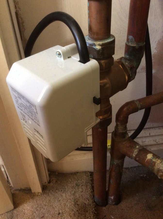

A homeowner fitted a smart thermostat themselves on what looked like a Y-plan system (one 3-port motorised valve, hot water cylinder, separate room stat). The wiring went in following the manufacturer’s manual and, on the face of it, everything worked – hot water on demand, heating on demand, app control all behaving. The catch: every so often, usually in the middle of the night, the circulating pump would burst into life on its own. Both heating and hot water were ‘off’ at the controls, yet turning the cylinder thermostat down silenced the pump every time. Boiler PCB was replaced a couple of years back, the 3-port valve about a year ago. The question is the obvious one – is this a wiring cock-up from the swap, a dying cylinder stat, or something deeper in the boiler?
What’s likely going on
This is a classic story of a smart stat going onto an older Y-plan setup. The symptoms point hard at a control wiring issue rather than a failed component. Here’s the logic: if turning the cylinder stat down stops the pump, the cylinder stat is the thing closing the circuit. But on a properly wired Y-plan, the cylinder stat should only have a live feed when the programmer (or in this case the smart stat’s heat link) is actually calling for hot water. No call, no live, no way for the stat to switch anything on.
So if the pump is running with everything ‘off’, the cylinder stat is getting a live from somewhere it shouldn’t. Nine times out of ten that’s down to one of two things: a pair of wires swapped at the heat link (the ‘call for heat’ and ‘satisfied’ wires are often the same colour – both yellow on some setups), or wires the wrong way round at the cylinder stat itself. Don’t rule out a previous installer having already had a fiddle – if the old programmer was a simpler one, a quirk in the wiring might have been masked for years and only shows up now the new controller actually uses all the terminals.

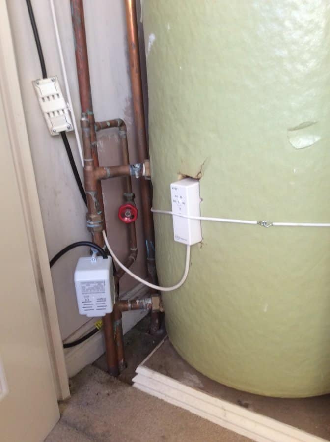

Green fibreglass hot water cylinder with copper pipework, a Grundfos circulating pump, and two white control units mounted on the wall beside it
The hot water cylinder, circulating pump and control wiring as installed – typical of an older Y-plan system.

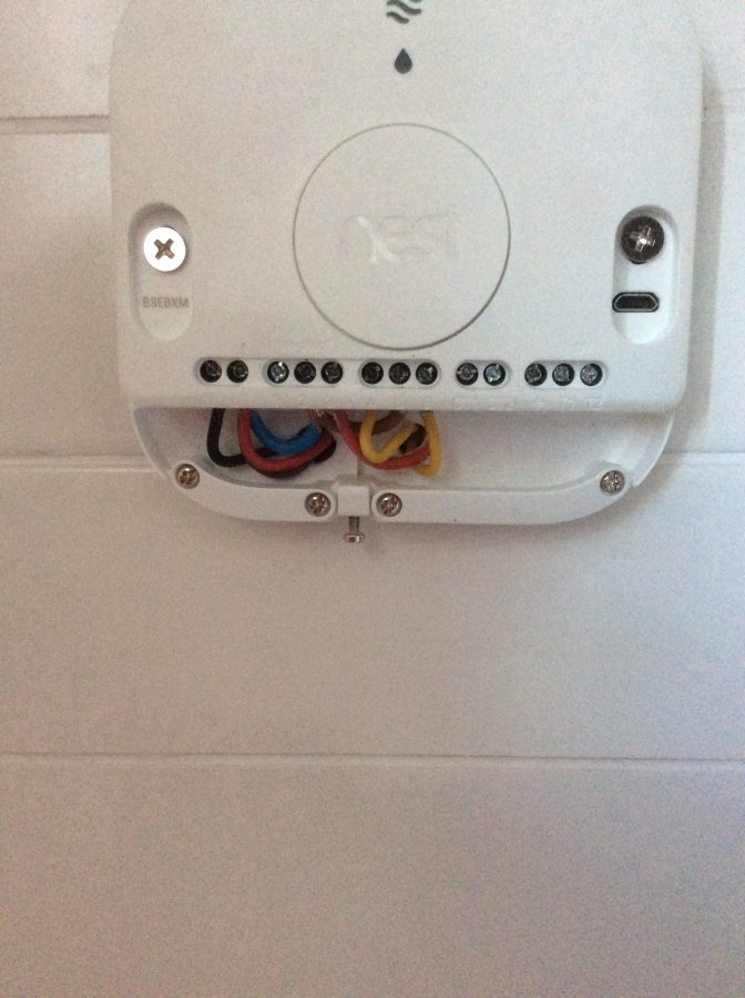

Rear of a Nest thermostat mounted on a wall, showing coloured wires connected to the terminal block on the base plate
The Nest thermostat wiring – getting the terminal connections right on a Y-plan system is where faults most often creep in.

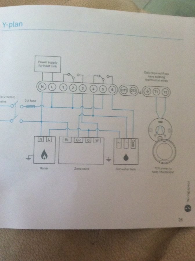

Good: Take the wiring back to a known-good diagram for your specific system type. For a Y-plan with a smart heat link, that means the hot water ‘call for heat’ terminal feeds the cylinder stat common, the stat’s ‘call’ output feeds the valve’s orange wire (which drives the valve motor to the hot water position), and the grey end-switch wire on the valve feeds back to the boiler and pump to fire them once the valve has opened. The heating ‘call’ terminal feeds the valve’s white wire to drive the valve to the heating position. Confirm with the meter that each wire is live only when it should be, before screwing the covers back on.

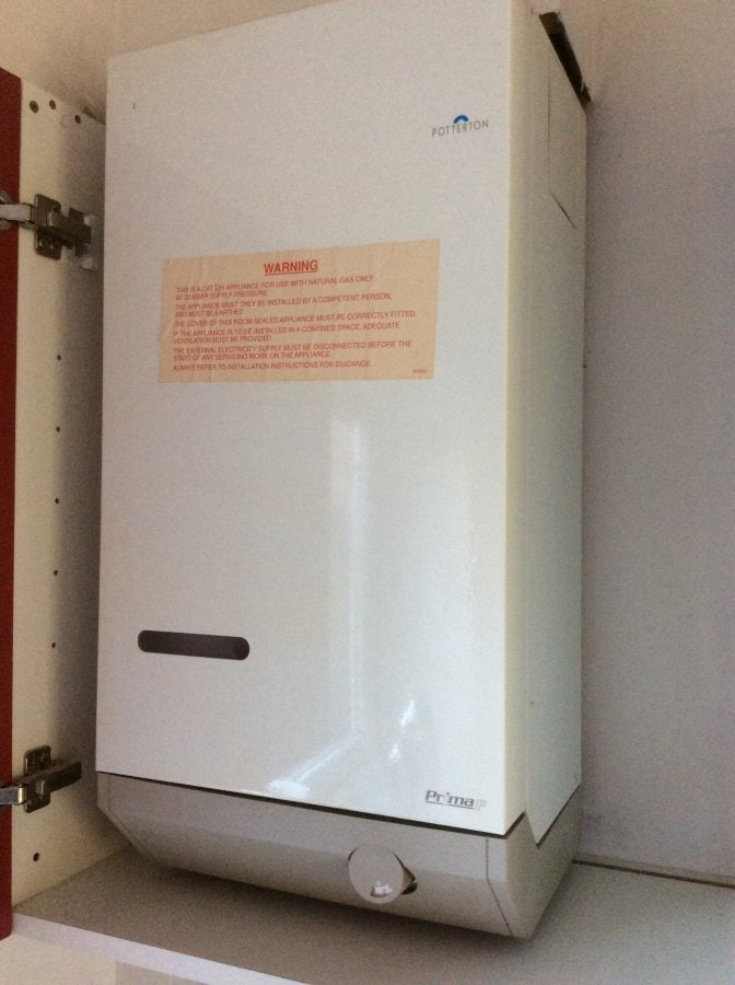

Potterton Prima gas boiler mounted inside a kitchen cupboard with a yellow warning label on the front panel
The Potterton Prima boiler – its PCB was replaced a couple of years ago, making it an unlikely cause of the overnight pump runs.
Best: Get a heating engineer or electrician familiar with smart controls to commission it properly. They’ll prove every conductor with a meter, check pump overrun is wired through the boiler’s dedicated terminals, and confirm the valve is moving fully to each position. On older boilers like a Potterton Prima F, pump overrun is provided by a thermostat inside the boiler that switches the pump from the switched live to a permanent live – if that’s wired up wrong externally, you get exactly the kind of phantom pump running being described.

Nest Heat Link Y-plan wiring diagram from the installation manual, showing connections for boiler, zone valve, hot water tank and thermostat
The Nest Y-plan wiring diagram from the installation guide – following this correctly is critical to avoiding stray switching faults.
