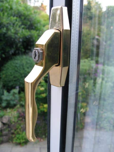

  • Turn the handle and watch how it moves. If the whole body wobbles on the frame but the locking action still works, you’ve got loose fixing screws. That’s the easy fix.
  • If the handle spins freely without locking the window, the spindle or gearbox has failed inside the frame. That’s a different job, and a new handle alone won’t sort it.
  • Look for a small cover or rose at the base of the handle, where it meets the frame. On many handles this rotates or slides to expose two screws. Try turning it 90 degrees with your fingers first.
  • With the handle in the locked (downward) position, look along the back plate where it meets the uPVC. If you can see a hairline gap, that’s your clue: the back plate is a clip-on cover, not part of the handle casting.
  • Check if the handle is keyed. If it is, lock and remove the key before you start poking around, so the spindle stays put.
If the handle wobbles but still locks, you’re almost certainly looking at loose screws behind a cover. If it won’t lock at all, skip ahead to the gearbox section.
Gold-coloured brass uPVC window handle with keyhole lock fitted to a white double-glazed window frame, garden visible through the glass behind
A typical key-lockable uPVC window handle with no visible fixing screws — the type found in many UK double-glazed homes.

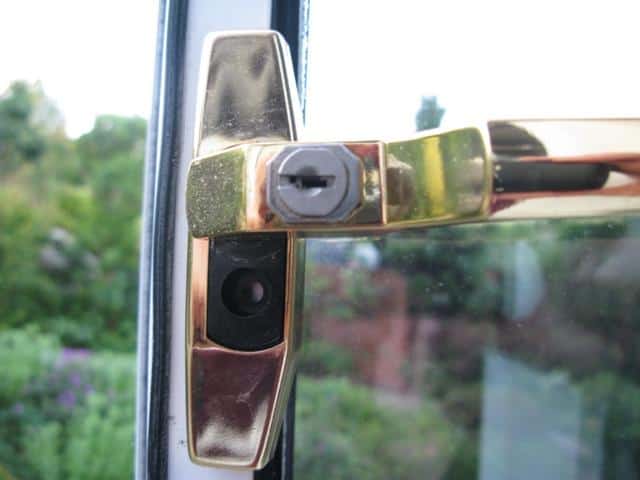

How to get to the hidden screws
On the clip-on back plate type, the method is straightforward:
  • Turn the handle to the locked (downward) position. This lines up the cover so it can be released.
  • Take a thin, stiff blade: a decorator’s knife, a thin filling knife, or an old kitchen knife you don’t mind marking.
  • Slide the blade into the gap between the back plate and the window frame, at the base of the handle.
  • Gently lever the back plate towards you, away from the frame. It should pop off the clips with a small amount of force.
  • Underneath you’ll find two (sometimes four) crosshead screws holding the handle body to the frame.
  • Nip them up with a screwdriver. Firm but not gorilla-tight. uPVC and the metal reinforcement behind it will strip if you overdo it.
  • Click the back plate back on. Job done.
If the back plate won’t shift after a fair bit of gentle pressure, stop and look again. Some designs have a tiny grub screw on the underside, or a rose that twists rather than levers. Don’t keep forcing it or you’ll crack the cover.

Close-up of a brass uPVC window handle showing the keyhole cylinder and a small black plastic button on the backplate beneath it
A close-up showing the keyhole and the small release button on the backplate, which must be pressed to remove the handle without damage.
