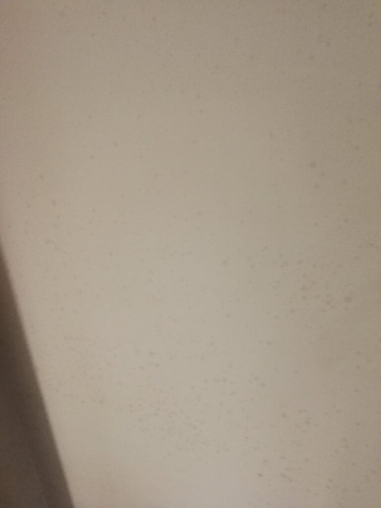

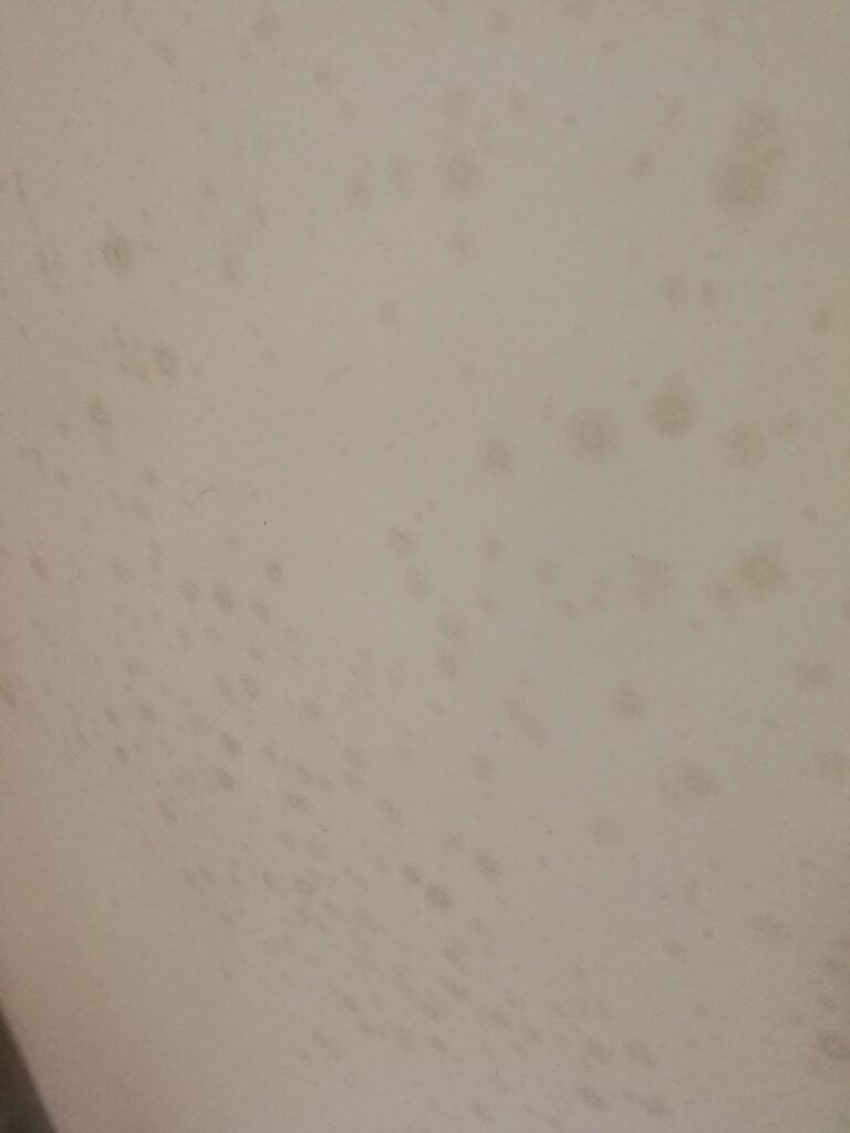

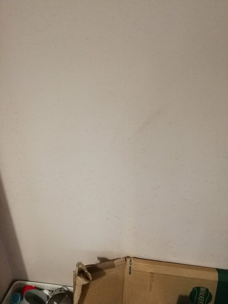

A homeowner in a UK property noticed small damp spots, roughly 5mm to 10mm across, spreading over one internal living room wall and creeping onto others. The room had been replastered the previous year, and the house was mid-extension with no working boiler or heating at the time. Condensation was visible on the windows, mould had appeared behind the sofa, and black spots were forming around the window frames. The spots had been worsening over several months and were climbing higher up the wall.
Damp spots on living room wall
What’s Likely Going On
This is a common one in UK houses, and this particular situation has a few things stacking up against it. The biggest clue here is the combination of no heating, recent plastering, building work disrupting the normal airflow of the house, and washing being dried indoors. Each one of those on its own raises the moisture level inside the property. Put them all together and you’re creating conditions where damp and mould are almost inevitable.
Here’s the chain of events. Fresh plaster holds a significant amount of water – it can take months to fully dry out, and during that time it’s releasing moisture into the air. Normally your heating system helps deal with that. Warm air can hold more moisture than cold air, so when you heat a room, the relative humidity drops. That drier air then picks up moisture from damp surfaces, and when you ventilate – opening windows or running extractors – that moisture-laden air gets swapped out for fresh air. Without heating, this cycle breaks down. The air inside the house sits at roughly the same humidity as outdoors, which in the UK is often above 80%. Add moisture from cooking, bathing, breathing, and drying clothes, and the internal humidity climbs even higher with no mechanism to bring it back down.
The small, evenly distributed spots across the wall are characteristic of condensation settling on a cold surface. An internal party wall shared with a neighbour can be surprisingly cold if the neighbour’s heating is off or if there’s poor insulation in the cavity. The moisture in the air hits that cold wall surface, condenses, and gives mould spores exactly what they need to get going. The fact that the spots started lower and have been creeping upward fits – the lower portions of the wall are typically the coldest, and as conditions worsen, mould colonises further up.
