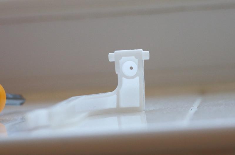

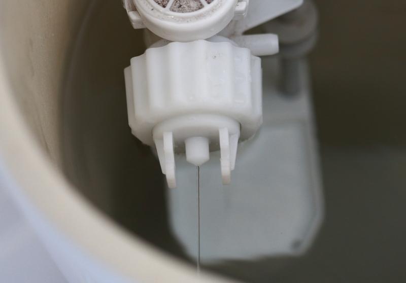

A homeowner has a Siamp Compact 99B side-entry fill valve in the loo cistern that won’t shut off – it just keeps filling. They’ve already swapped the inlet diaphragm but the problem hasn’t gone away. Looking at the valve, they can see water trickling out of a small hole on the body, and there’s a lever arm on the float that’s meant to come up and close that hole off as the water level rises – but the lever arm itself has a hole through it too. They’re scratching their heads about how this thing is actually meant to seal, and whether a part is missing.

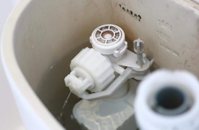

The Siamp Compact valve is a servo (or pilot) operated diaphragm valve. It doesn’t shut the mains water off directly with the float – the float only has to close one tiny pilot hole. Here’s the chain of events:
  • Mains water pushes up against the back of the diaphragm.
  • A small bleed hole lets a trickle of water through to the chamber behind the diaphragm.
  • That little chamber drains away through the pilot hole – the one you can see water dribbling out of when the cistern is filling.
  • Because water can escape from behind the diaphragm faster than it leaks in, pressure stays low behind it, and mains pressure on the front lifts the diaphragm off its seat. Valve open, cistern fills.
  • As the float rises, the lever arm pushes a small silicone or rubber pad up against that pilot hole and blocks it.
  • With the pilot hole now sealed, pressure builds up behind the diaphragm, equalises with the mains pressure, and the diaphragm is pushed firmly back down onto its seat. Valve shut.

To answer the question directly: yes, the lever arm on a Siamp does have a hole through it, but inside that hole there should be a small soft pad (often a clear or translucent silicone disc) that does the actual sealing against the valve body. If that pad has perished, fallen out or was missed when someone serviced it before, the float arm will rise as designed but the pilot hole stays open, and the valve will never shut off. That fits your symptoms exactly.

  • Inspect the lever arm where it meets the valve body. You’re looking for a small soft sealing pad seated in the arm. If it’s missing, deformed, brittle, or has a chunk torn out, that’s your problem. A good pad looks plump and slightly tacky; a bad one is hard, cracked, or simply not there.
  • Check the pilot hole on the valve body itself. It should be clean and sharp-edged. Bits of grit, limescale or PTFE tape stuck in there will stop the pad sealing properly even if the pad is fine.
  • Check the diaphragm orientation. On these Siamp valves the diaphragm has a locating slot on the back that has to line up with a peg on the valve body. If it’s been put back rotated wrong, the bleed hole and the seat won’t be in the right place and the valve will misbehave, including not shutting off. Pop it out and re-seat it making sure the slot is on the peg.

Good: replace the missing pad.
If you can get hold of the correct Siamp service kit (diaphragm plus the small sealing pad for the arm), pop the new pad into the lever arm, refit the diaphragm with the locating slot lined up on the peg, and you’re sorted. Cheapest fix, keeps the original valve. Downside: on older valves the plastic on the arm itself can be worn where the pad sits, and a new pad won’t seal properly on a chewed-up seat.
