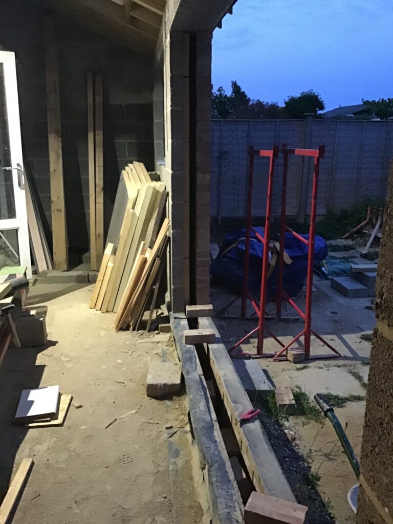

Rear house extension under construction at dusk, showing timber boards leaning against a blockwork wall, red acrow prop scaffolding in the garden, and an open cavity wall threshold with no door frame fitted
The extension shell at an early stage, with the rear opening clear and materials stacked ready for the bifold installation.

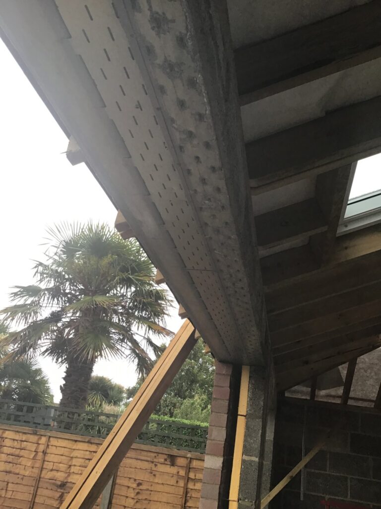

Head: a proprietary cavity lintel (IG or similar) is a pressed steel section. It’s not thick enough to take self-drilling tek screws reliably and the steel is often galvanised, which you don’t want to chew through. The usual approach is to fix up through the inner flange of the lintel into a treated timber packer set in the lintel’s box, or to use the manufacturer’s recommended fixing detail (some lintels have pre-drilled fixing flanges or accept specific frame fixings). If you’ve got a single rolled steel beam instead, plan the track position so your fixings hit the flange, not thin air either side of the web (the web being the vertical part in the middle of an I or H section). Don’t guess – prove it. Mark out where every fixing lands before you offer the frame up.

The threshold and cavity detail at the floor
This is where the original question really mattered. Carrying the cavity straight across the opening at floor level is messy and often cold-bridges. The cleaner way:

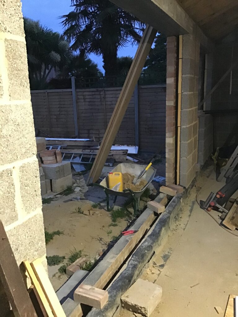

Construction site of a rear extension at dusk, showing a cavity wall opening with brick and blockwork reveals, a timber prop bracing a board diagonally, and a wheelbarrow containing sand in the foreground
The bifold opening with brick reveals and cavity wall construction visible, illustrating the fixing surfaces available for the frame jambs.
  • The inner blockwork stops at slab level (or is taken down to foundation as a thermal break detail with insulation between).
  • Floor insulation runs across the full width, including under where the door sits, and butts tight to the cavity insulation.
  • Screed goes over the insulation and finishes up to the threshold.
  • The bifold sits on a structural bearing – typically the inner leaf or a bedded sub-cill – with DPC lapped properly up and out, dressed into the cavity tray principle so any water drains to the outside.
That way your floor finish runs right up to the door without a cold strip of block underneath it. The DPC needs to lap so any water that does get in finds its way back out via the outer skin, not into the room.

Underside view of a concrete block and beam floor or lintel spanning across a rear extension opening, supported by timber props, with a palm tree and garden fence visible behind
The underside of the proprietary cavity lintel spanning the bifold opening, showing the bearing surfaces and temporary propping still in place.
