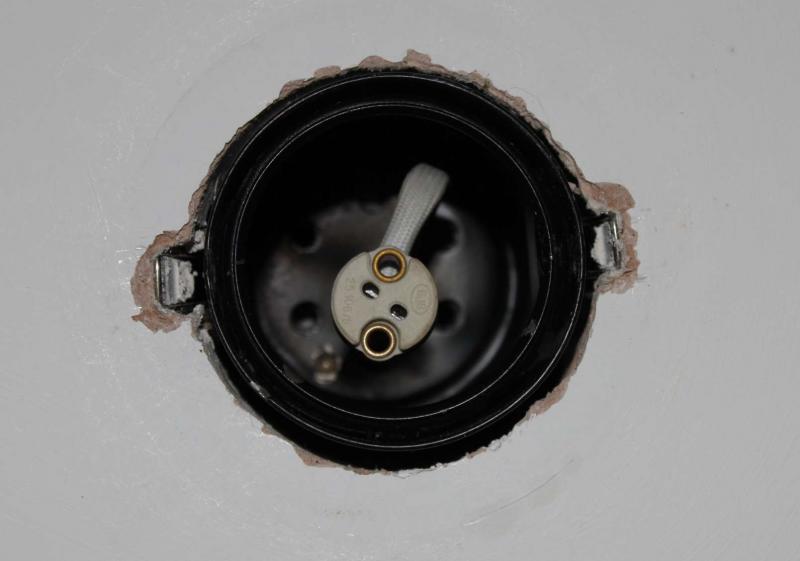

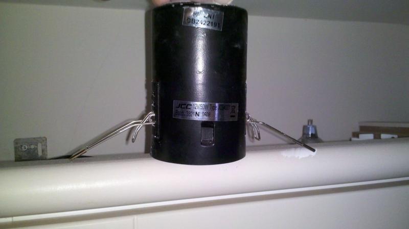

A homeowner with 12v MR16 downlights set into plasterboard ceilings needed to get at the transformer after the low-voltage lead to the bulb failed. The fittings – fire-rated JCC types with twin-tong spring clips – refused to budge despite compressing the visible clips inward. Every pull just flexed the plasterboard and started chewing up the edges of the hole. They wanted to get the fitting out cleanly, replace the failed lead, and ideally upgrade the whole lot to mains-voltage GU10 fittings.
What’s likely going on
This is a common one in UK houses, particularly where fire-rated downlights were fitted in the mid-2000s. The fittings use a retention clip system with two spring-loaded “tongs” per side rather than a single one. The short inner arms wedge outward against the edge of the hole in the plasterboard, while the longer outer arms grip behind the board. The tighter the hole was cut, the harder they grip – and JCC fittings are known for having almost no rim overhang, so there’s nothing to hide minor plaster damage if you scuff things up.
The reason compressing the clips doesn’t free the fitting is that you’re only dealing with the inner arms. The outer arms are still locked behind the board. The fitting is designed so that you pull the whole body downward, the inner arms gradually release their wedging force, which in turn lets the outer arms fold inward enough to pass through the hole. It’s counter-intuitive – you feel resistance and think something is jammed, but the mechanism needs a steady, even pulling force on the fitting body itself.

JCC fire-rated downlight fitting showing twin-tong spring clips used to hold it in the ceiling
Simple checks first
Look at the fitting from below and identify the clip type. If you can see two small metal tabs poking inward on opposite sides, those are the inner arms of a twin-tong clip. Don’t try to prise these out with pliers – that just damages the plasterboard edge and doesn’t address the outer arms behind the ceiling.
  • Check whether the fitting has a removable bezel or trim ring. Some have a bayonet-fit front ring that twists off. Removing it can give you a slightly better grip on the main body and sometimes reveals a fractionally wider gap to work with.
  • Measure the hole diameter if you can. JCC fire-rated fittings typically use a 63–65mm cutout. If someone cut the hole tight, you’ve got almost no clearance, which explains why the springs bite so hard. Knowing the hole size also matters if you end up replacing the fittings with something more forgiving.
  • Check for access from above – lifted floorboards or a loft hatch. If you can get above the ceiling, you can push the fitting down from the back, compress the clips manually, and at least see whether anything else is holding it (cable ties or pipes, insulation packed tight around the can, that sort of thing).

The good option is to work the fitting out through the existing hole. Grip the body of the fitting firmly – not the clips – and pull straight down with steady pressure. If it won’t come, try rocking it gently side to side: pull one edge down a centimetre, then the other. This loads the springs one at a time rather than fighting both together, and it’s much kinder to the plasterboard. Refit the trim ring first if you removed it, as it gives more to grab onto. Some people have had success sliding a thin plastic card (an old loyalty card works) between the spring arm and the plasterboard edge to act as a shield and reduce the grip. Be prepared – when it releases, the springs can snap back sharply, so keep your fingers clear.
The better option, if pulling from below is clearly going to damage the ceiling, is to push the fitting upward into the ceiling void. Use a flat tool or even your thumbs to press the body up past the clips. Once it’s loose above the ceiling, you can fold the clips flat, pull it back down through the hole, and deal with the wiring from below. This is slightly unorthodox but actually works well on the stubborn twin-tong types.
The best option – and the one I’d go with if the fittings are old and the lamp leads have already failed – is to replace the lot. Pull the old fittings out (accepting some minor plaster damage), and fit modern downlights with a larger cutout diameter, typically around 70–74mm. The bigger hole covers any scarring left by the old fitting, and modern fittings tend to use single-tong clips that are far easier to remove in future. You can get fire-rated GU10 types with open backs that accept any lamp, and many are available as Class II (double insulated) so they don’t need an earth connection – useful if your existing circuit is just twin-and-earth without a spare conductor.
