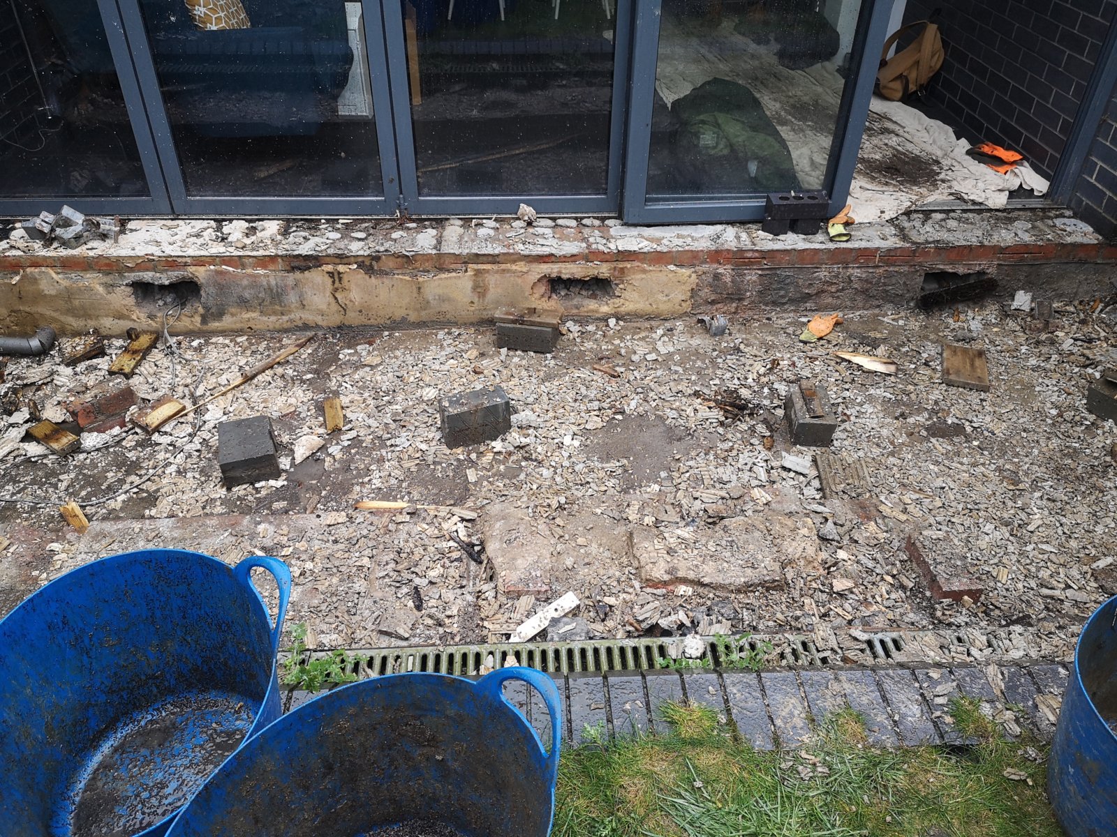

A homeowner has lifted a failing patio at the back of the house and found it had been laid over timber decking with a bit of concrete near the wall – no wonder it was moving. Now the ground is opened up, they can see three ventilation channels under the door threshold that were previously buried under the old build-up, with no proper air bricks fitted. They want a new patio flush with the kitchen floor for a level threshold, but the rest of the garden sits higher than the DPC. The question is how to put in a proper patio at that level without choking off the sub-floor ventilation.

In this case the previous lot buried the ventilation openings under decking and tiles. There's been no proper airflow for who knows how long. The reason there's no damp showing yet is probably a mix of luck, the void being reasonably dry, and the timber not having reached the point where it lets go. Just because you can't see a problem doesn't mean the floor structure isn't slowly taking on moisture. Water gets in, then it shows up somewhere else, often years later when a joist end crumbles.
The other issue is levels. You want the patio flush with the kitchen floor for a nice threshold, but the DPC and the air bricks sit low on the wall. Paving hard up against the wall at floor level will bridge the DPC and block the vents. Both are bad news.

  • Measure from the internal finished floor down to the top of the DPC (usually a black plastic strip in the mortar bed, two courses up from the ground typically). You need paving to finish at least 150mm below the DPC, ideally more.
  • Find where the vent openings actually are. Are they proper air brick openings through to the void, or just gaps in the brickwork? Shine a torch in – can you see the sub-floor void, joists, or just rubble?
  • Check the state of the joist ends nearest the wall. Push a screwdriver gently into any exposed timber. If it sinks in, you've got rot starting and that needs sorting before you close anything up.
  • Look at the ground levels around the rest of the garden. How much higher is it? Is there a fall away from the house, or does everything drain towards it?
  • Check inside – lift a floorboard near the external wall if you can. Have a sniff and a feel. Damp, musty, or cold and dry? That tells you a lot about whether ventilation has been failing quietly.
If the joist ends are soft, stop and deal with that first. No point putting a lovely new patio down over a rotting floor.

The simplest and cheapest option is to accept that the patio needs to sit low enough to keep the air bricks clear, and put a step down from the kitchen door. Not what you asked for, I know, but it's the most foolproof. The garden being higher isn't really the issue – you're only stepping down from the door threshold, then the patio can rise or the garden can be retained separately.
  • Patio finished level a good 150mm below DPC and below the air brick openings
  • Fall of about 1 in 60 away from the house
  • Proper air bricks fitted into the openings with telescopic sleeves through any render or facing

A demolished patio area outside sliding glass doors, showing rubble, broken concrete, scattered bricks, and a linear drainage channel, with blue builders' buckets in the foreground.
The cleared patio reveals the old timber decking and concrete build-up that had been concealing ventilation channels beneath the door threshold.
If you really want the patio close to threshold level, you can extend the ventilation out and up using ducting, similar to the way builders duct air bricks through a new extension slab. You run a rigid duct (soil pipe or purpose-made periscope vent) from each existing opening, out under the paving, and terminate it somewhere it can breathe – either up through the patio in a discreet spot, into a retaining wall face, or into the side of a deep drainage channel that sits along the house.
The drainage channel (aco-type) does two jobs: it stops surface water from running towards the door and threshold, and it gives you somewhere to terminate the vents above patio level. You need to be careful the channel doesn't overflow into the vent openings, so oversize it and make sure it drains properly to a soakaway or gully.

The neatest solution if you want that flush threshold is a concrete slab or firm sub-base laid low, below DPC and air brick level, with the finished paving sitting on adjustable pedestals above it. That leaves a ventilated void under the patio itself, and the air bricks vent freely into that void, which then breathes out around the edges of the paved area.
This is essentially how balconies and roof terraces are done. It gives you a level threshold, keeps the DPC and vents clear, and the paving lifts out for access. It costs more, and the pedestals need decent quality porcelain slabs to work well, but done right it's the tidiest answer to your exact problem.
