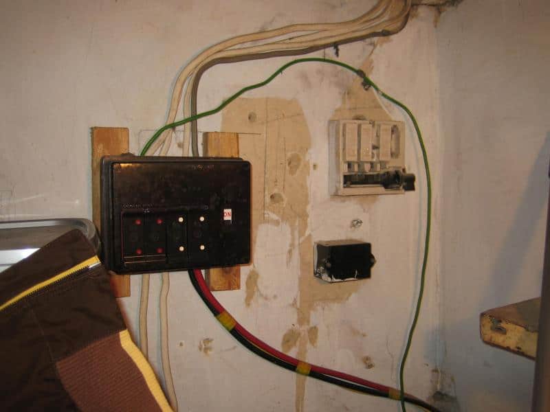

Old wooden-backed consumer unit with rewireable fuses mounted on timber batten, with green earth wire, red and black cables, and a separate fuse cutout on a bare plaster wall
A typical older wooden-backed fuse board as found in an ex-rental property, showing the incoming cables, earth wire, and a separate fuse cutout on the wall nearby.
  • Count the circuits at the board. Four ways for a whole house is light. A modern small house typically wants separate circuits for upstairs sockets, downstairs sockets, kitchen, upstairs lights, downstairs lights, cooker, immersion, boiler. If everything’s lumped onto a handful of fuses, circuits are likely overloaded or shared.
  • Look for RCD protection. If there’s no test button anywhere on the board, there’s no RCD. That’s a big one for safety on sockets and anything taken outdoors.
  • Check the main earth and meter tails. The thick cables going to and from the meter should look chunky and modern. Thin, cloth-covered or undersized conductors are a flag.
  • Look for bonding clamps on the gas and water pipes where they enter the house, close to the meter and stop-tap. A green/yellow cable with a labelled clamp, “Safety Electrical Connection Do Not Remove”, should run back towards the consumer unit area. Missing clamps means bonding is likely absent.
  • Walk the house and look at sockets and switches. Round-pin sockets, brown bakelite fittings, or cloth-covered flex coming out of anywhere = old wiring still in use. Cracked faceplates, scorch marks or warm switches = stop using and get it looked at.
  • Lift a socket faceplate or two (power off at the main switch first, and only if you’re confident) and look at the cable. Rubber insulation that’s gone hard, or black rubbery cable, is a rewire job. Modern PVC twin and earth in reasonable nick is a much better starting point.
  • Ask the seller or agent for paperwork. As a rental, it should have had an Electrical Installation Condition Report (EICR) within the last five years. If they can produce it, that tells you a lot for free.
The result of these checks tells you whether you’re looking at a tired but salvageable installation, or whether the bones of it are past it.

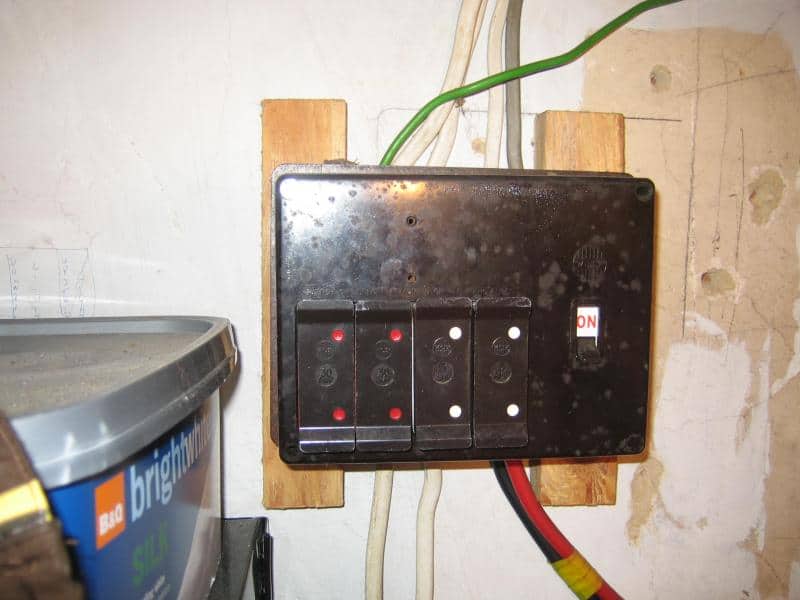

Don’t guess, prove it. Before committing to either route, get a qualified electrician in to carry out an EICR (sometimes still called a PIR by older sparks). They’ll test insulation resistance, earth fault loop impedance, polarity and continuity on every circuit, and give you a written report with coded faults. That report is the single most useful thing you can buy at this stage. Usually a couple of hundred quid, and many electricians will knock it off the price of any remedial work if you go ahead with them.
Good, the staged approach. If the EICR comes back saying the circuits themselves are basically sound but the board, earthing and bonding are not, you can do the headline job now and live with the rest: new 18th-edition consumer unit with RCD/RCBO protection, upgraded meter tails, properly sized main earth, and main protective bonding to gas and water. That gives you a safe, modern heart to the system. You can then upgrade circuits one at a time as you redecorate room by room. This suits a first-time buyer budget and gets you the biggest safety win for the least money.
Better, board plus targeted rewiring. Same as above, but you also rewire the circuits the EICR flags as borderline, plus the kitchen (which always wants its own dedicated circuits these days). Kitchens tend to be the highest-load area and the most likely to have been bodged over the years.
Best, full rewire now, while the house is empty. If the EICR comes back with multiple C1/C2 codes, rubber-insulated cable, or evidence of widespread DIY, bite the bullet. There genuinely isn’t a better time than before you move in. Floorboards come up easily, you don’t care about the existing decor, and you can put sockets and switches where you actually want them rather than where someone in 1975 thought they should go. A full rewire on a small terrace is disruptive but not the end of the world, and you’ll never have to think about it again.
Close-up of a black plastic rewireable fuse board with four fuse carriers and an ON toggle switch, mounted on a timber batten with green, red, and black cables visible below
Close-up of the fuse board showing four rewireable fuse carriers, two with red indicators lit, and a main on/off switch — a typical installation lacking modern RCD protection.
