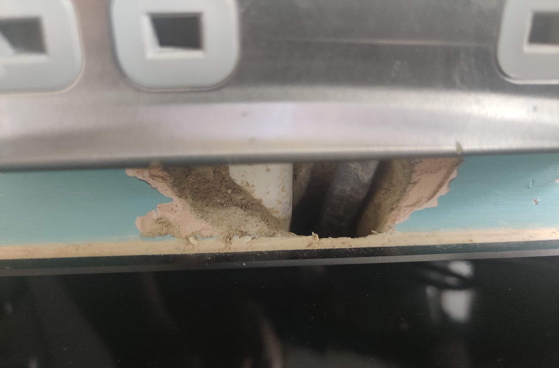

An electrician has cut a small chase into the kitchen wall below a socket and just above the glass splashback to sort out some cabling. The hole now needs making good, but there's uncertainty about whether the cables should be "capped" before filling over them, what capping actually is, and the safe steps to follow – turning power off, removing the socket, filling in layers and so on. The homeowner wants to do it by the book without paying a tradesperson for a ten-minute job nobody wants to turn up for.

Close-up of a small chase cut into a teal kitchen wall just above a glass splashback, below an electrical socket, showing exposed plaster, dust and cables visible through the gap
The chase cut into the wall below the socket, showing the gap that needs filling before the area is made good.

  • Look at the cable sheathing where it's exposed. If the outer grey sheath is intact and undamaged, you're filling over a properly insulated cable and there's no bare copper anywhere near your filler. That's what you want to see.
  • Check the cable isn't under tension or pulled tight across a sharp edge of the chase. If it is, ease it so it sits naturally in the slot.
  • Have a look at how deep the chase is. You want at least a few millimetres of filler over the cable once it's finished. If the cable is proud of the wall surface, that's a problem to flag to the electrician, not something to bury.
  • Check the socket faceplate screws and the position of the box. If the box is loose or the faceplate won't sit flush after filling, you'll want to sort that before you make good.

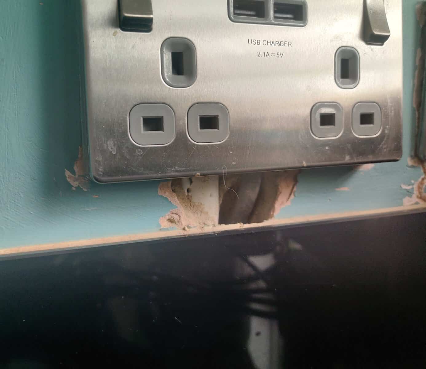

A double UK mains socket with USB charger ports mounted on a teal kitchen wall, with a ragged hole in the plaster visible beneath the socket faceplate just above the glass splashback
The socket above the chase, illustrating how little clearance there is between the fitting and the splashback.
  • Good: fill in two or three layers with a setting-type filler, no capping, cable sitting flat. Perfectly acceptable for a small patch under a socket. Longevity is fine as long as the wall stays dry.
  • Better: same as above but drop a short offcut of plastic capping over the cable before filling. Costs pennies, gives you peace of mind, and looks the part if anyone opens it up later.
  • Best: get the electrician back for ten minutes to widen the chase enough to fix proper capping with galvanised nails, then skim the whole patch with bonding coat and finish plaster for a seamless repair. Overkill for a hole this size, but it's the by-the-book answer.
