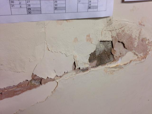

Peeling and crumbling lath and plaster wall showing multiple layers of paint and plaster separating from the substrate, with a calendar pinned above
Lath and plaster failing at the surface, with paint and render layers peeling away — a common sign the backing has lost its key.

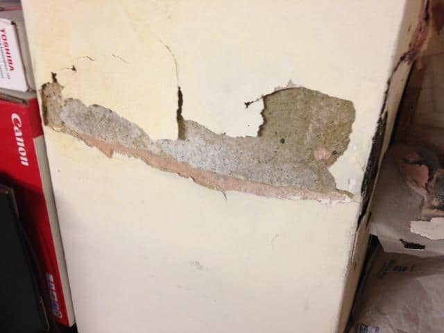

Large section of lath and plaster wall with paint and render stripped back to expose the grey plaster undercoat and brick substrate beneath
Plaster stripped back to reveal the undercoat and masonry below — typical of what you find once a failing surface is opened up.

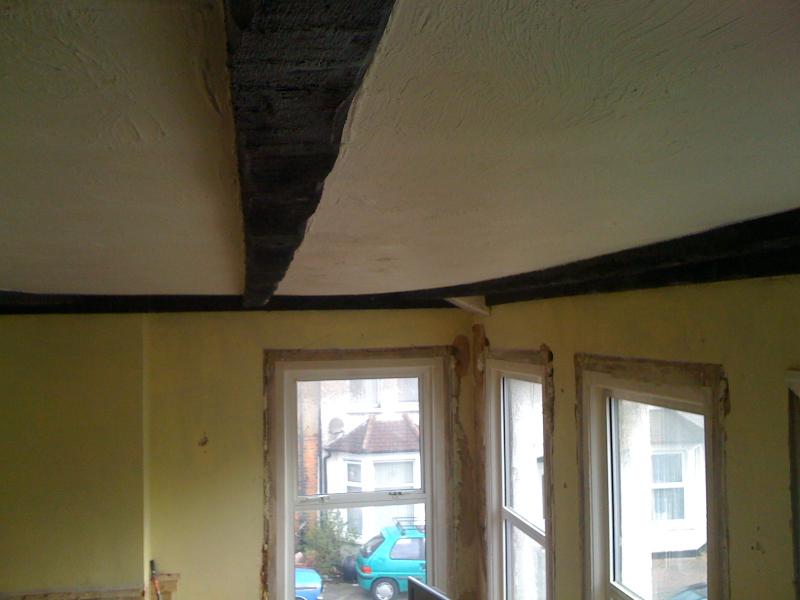

If the ceiling is bowed, cracked in multiple places, or drums when you tap it, the honest answer is it needs to come down. Yes, it’s filthy work. The dust from a century-old ceiling is something else. Dress for it:
Lath and plaster ceiling partially collapsed, exposing the dark timber laths and structural joists above, in a room with bay windows
A lath and plaster ceiling mid-strip, showing the timber laths exposed where the plaster has given way — the point at which overbarding or full replacement becomes the decision.

If the joists themselves are bowed (and on old properties they often are), a new ceiling fixed straight to them will follow the same curves. The proper answer is to build a new level ceiling below. Fix timber battens or metal furring around the perimeter at the height you want, hang joists across, level with a laser or a long straightedge, then board and skim.
You lose 40 to 60mm of ceiling height, but you get a genuinely flat ceiling, better acoustic separation, room for insulation and services, and the old ceiling stays put doing no harm. This is the route I’d take in a room where the bowing is severe or the joists are clearly not straight.

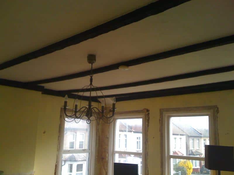

Replastered ceiling with dark timber beams in a period living room with bay windows and a wrought iron chandelier
The same room after the failed ceiling was dealt with — the structural beams are retained and the new ceiling surface is flat and sound.
