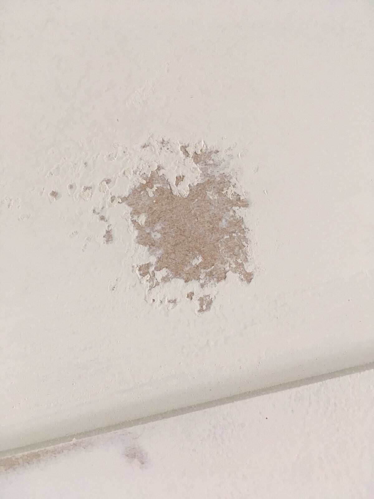

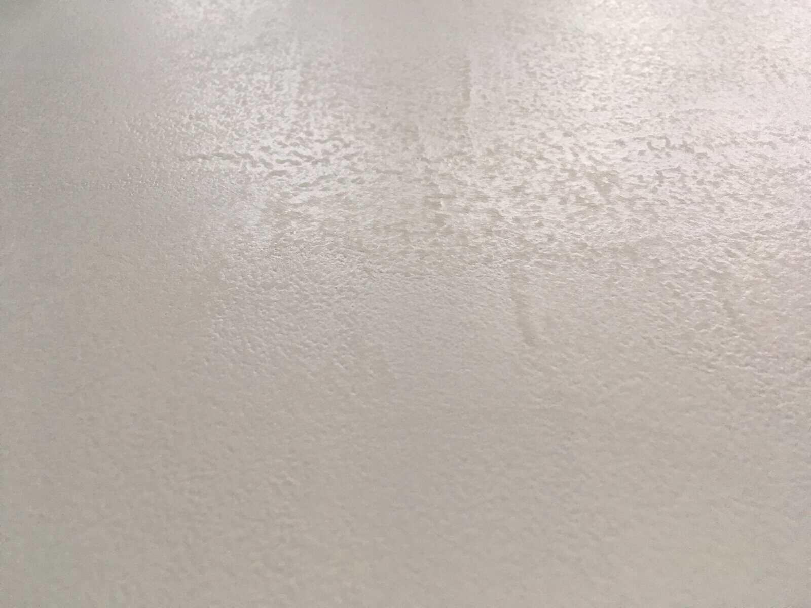

A homeowner set out to paint an MDF cupboard and doors to a nice white finish. They cleaned the MDF, then rolled on a shellac-based sealing primer (BIN) with a foam roller, working outside on a very hot day. The first batch came out just about acceptable after sanding, but the next day's work dried far too fast, leaving a heavily rippled, textured surface. When they tried to sand it back, chunks of primer lifted off in patches. Now they're stuck with a rough, damaged finish, a bare patch, and a second untouched cupboard waiting its turn. They want to know how to rescue the mess and what to use going forward.
This is a common one when people reach for a shellac primer on MDF without realising just how quickly it flashes off. Before you start again, it's worth understanding why it went wrong, because the fix depends on it.
What's actually gone wrong
Shellac-based primers (the meths/alcohol-based ones like BIN) are good products. They seal knots, block stains, and stick to awkward surfaces, but they dry extremely fast. In a cool workshop that's fine. Outside on a hot day, the solvent is flashing off almost as fast as you're laying it down. That means:
  • The roller drags through half-set primer, leaving heavy orange peel and ripples.
  • You can't lay it off smoothly because there's no open time.
  • The film sets hard quickly on the surface, but full cure and hardness develops over several days.
Sand it too early and you're pulling a half-cured skin off soft primer, which is exactly why big flakes came away. It wasn't the product failing, it was the timing.
Foam rollers make it worse too. They lay a stippled texture on everything, and with a fast-drying primer that texture sets before it has a chance to level.

  • Press a fingernail firmly into the primer in an out-of-the-way spot. If it dents or scrapes off easily, it's not cured. Leave it several days in normal indoor conditions before sanding.
  • Look at the surface in raking light (torch held low and sideways). This shows the true texture. If you can see roller stipple and ripples, you'll need to flatten it, not just scuff it.
  • Check the bare patch where primer lifted. Is the MDF fuzzy and raised, or clean? Raised fibres need feathering back before you re-prime.

If the primer has had enough time indoors and passes the fingernail test, you can sand it properly.
Rescuing what you've got
Good news: this is recoverable. You don't need to strip it back to bare MDF.
1. Let the existing primer cure fully in normal room temperature, away from direct sun.
2. Get hold of a random orbital sander. Hand sanding shellac primer is a thankless job. Start with 180 grit and work up to 240. Keep the sander moving, use light pressure, and let the abrasive do the work.
3. Aim to flatten the ripples until the surface feels uniformly smooth. You'll sand most of it off, which is normal and fine. As long as the MDF is sealed, you've done your job.
4. Spot-prime the bare patch and any areas you've sanded through. Feather the edges so there's no hard line.
5. Wipe down with a tack cloth or barely-damp lint-free rag before topcoating.

  • Painting in direct sun or high heat. The paint dries before it has a chance to level. Wait for cooler, still conditions. Indoors is usually best.
  • Sanding shellac primer too soon. You'll pull chunks off. Allow enough cure time, longer if it's cool or humid.
  • Foam rollers for the final primer coat. Fine for laying on, but they leave a texture. A short-pile microfibre or mohair roller gives a flatter finish.
  • Skipping the sand on hard surfaces. Manufacturer claims of "no sanding needed" on laminates and varnished surfaces are optimistic. A quick key with 180-240 grit dramatically improves adhesion.
  • Piling on thick coats to hide texture. Thick coats sag, dry unevenly and take forever to cure. Two thin coats beat one thick one every time.
