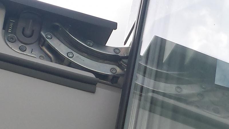

A centre-pivot roof window is designed to sit open at any angle from roughly 20 degrees up to around 45 degrees without you holding it, with the sash balancing against gravity through the friction hinge mechanism. The pivots have a friction mechanism built in that grips the pivot and stops the sash from flopping shut under its own weight. The glazed sash on these units is heavy, so the friction has to be set correctly to counter that weight.
If the window is swinging shut the moment you let go, one of three things is going on. Either the friction hinges have not been set or tensioned after installation, the friction springs themselves are faulty or missing, or a transit or packing clip has been left in place and something isn't seated as it should be. When it's happening on both windows straight out of a new install, my money is on hinge tension not being set, or the wrong spec of spring for the size and weight of that sash.
Simple checks first (safe)
Before touching anything, get yourself a stable platform, a proper step or a small tower. Don't stand on a chair balancing an opening pole. If the window's high up and awkward, get someone to foot the steps.
  • Look at the pivot points on both sides of the sash. There are usually small covers or caps over the hinge mechanism. Pop one off gently with a thin blade. If you find an adjustment screw underneath, that's your friction tensioner. The presence of a screw confirms the hinge is adjustable and probably just needs setting.
  • Open the window slowly and watch how it moves. Does it feel like there's any resistance at all, or does it swing freely like a shop door? No resistance at all suggests the friction spring is disconnected, missing or faulty rather than just loose.
  • Check both sides behave the same. If one side has some grip and the other has none, the hinge on the loose side is the issue. If both are equally floppy, it's more likely a spec or setup problem across both units.
  • Look for any plastic transit clips, cable ties or foam packers around the hinges that shouldn't be there. New windows sometimes leave the factory with restraints that installers should remove.
  • Check the window is actually the right way up and fully engaged in the frame. On a centre-pivot, the sash should sit flush and even in the frame all the way round when closed. An uneven reveal can indicate the sash isn't seated properly on the pivots.
  • Find the data plate. It's usually on the top edge of the sash, visible when the window is rotated. Make a note of the model reference and year. You'll need it if you have to call the manufacturer.
Close-up of a centre-pivot roof window friction hinge mechanism showing the curved metal pivot arm and fixing screws on a dark frame
The friction hinge pivot arm on a centre-pivot roof window — the mechanism that holds the sash open at a set angle.
Proper fix – good, better, best
Good – adjust the hinge friction yourself

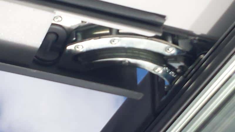

If you've found adjustment screws under the caps at the pivot points, this is a job a confident homeowner can do. With the window closed and supported, tighten each pivot screw a small amount, a quarter turn at a time, then test. Do both sides equally so the sash stays balanced. You're aiming for enough friction that the window holds position anywhere in its travel but you can still move it easily with the pole. Overtightening makes it a pig to operate and can wear the mechanism prematurely. Refit the caps when you're happy.
Better – request replacement friction springs from the manufacturer
If there's no meaningful adjustment available, or tightening makes no difference, the friction springs themselves are the issue. Contact the manufacturer's customer service with your model number and year off the data plate. They're generally very good about sending out replacement springs free of charge, even years after install, because it's a known wear item. Fitting them is a screwdriver job once you have the parts and the instructions. The covers come off, the old spring lifts out, the new one clips in. Do one side at a time so you've always got a reference.

Centre-pivot roof window hinge assembly viewed from outside, showing the curved metal pivot bracket, adjustment screws, and glazing edge
The hinge assembly seen from the exterior, showing the pivot bracket and the screws that control friction adjustment.
Nine times out of ten on a new install, a call to the fitter or a set of replacement springs from the manufacturer sorts it without drama.
