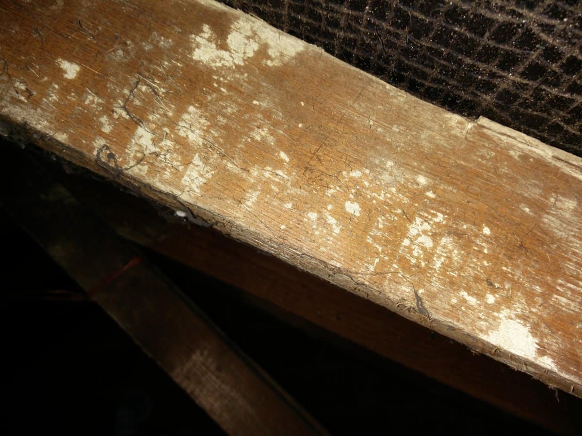

A homeowner in a 1960s house has spotted odd white patches on the roof rafters up in the loft. They don't stand proud of the timber like fluffy mould would – they look like dry, bleached areas, and if you scratch them a fine dust comes off. The loft is part-boarded, has fairly new insulation, an old black bitumen (non-breathable) felt under the tiles, and a boiler has recently been installed up there. The question is simple enough: what are these marks, do the timbers need chemical treatment, or is it really just a ventilation problem?

Nine times out of ten, white spotting on loft rafters in a 1960s house with old black felt is down to condensation. Not a roof leak, and not woodworm. The chain of events goes like this: warm, moist air from the house (kitchens, bathrooms, breathing, drying clothes, and now a boiler flueing or venting warmth up there) rises into the loft. The old bitumen felt is non-breathable, so that moisture can't pass out through the roof. It hits the cold underside of the tiles and the felt, condenses, and drips or wicks back onto the timbers. Over time you get repeated wetting and drying cycles on the rafters.
The white patches are usually one of two things: a surface mould or mildew (often called white spot mould) that grows in that damp microclimate, or bleached timber where moisture has drawn salts and lignin to the surface. Both point at the same underlying issue: the loft is too damp because it isn't ventilated properly. Adding a boiler and topping up insulation often makes it worse, because you've trapped more warmth and moisture below and reduced the airflow around the eaves.

Close-up of a wooden roof rafter in a loft space showing patchy white powdery deposits on the timber surface, with dark bitumen roofing felt visible above.
White powdery patches on a loft rafter beneath old non-breathable bitumen felt — a typical sign of condensation-related moisture problems.
  • Look at the felt itself. Any black staining, sagging pockets holding water, or damp patches directly under tile laps? Wet felt with clean rafters points to a leak. Dry felt with patchy rafters points to condensation.
  • Check the eaves. Can you see daylight at the edge where the insulation meets the wall plate, or is the insulation stuffed right up tight to the felt? If airflow is blocked at the eaves, the loft can't breathe.
  • Feel the timbers. Are they actually damp, or just marked? Bone-dry timber with white patches usually means the problem has been intermittent: wet in winter, dry now.
  • Scratch test. If a light scratch gives fine dust and clean timber underneath with no soft or crumbly wood, you're not looking at rot. Soft, spongy timber is a different conversation.
  • Look for droppings or fine bore holes. Small round holes and dust piles could be woodworm, which is a separate issue. White patches without holes aren't woodworm.
  • Check the boiler installation. Is the flue properly sealed where it passes through the roof? Any pipework or fittings sweating? A poorly sealed flue can dump moist air straight into the loft.
  • Inside the house, look for signs of damp. Peeling paint on the ceiling below, staining round the loft hatch, or a hatch that isn't sealed and insulated. All of these let household moisture straight up.
If the timber is dry, structurally sound, and there's no obvious leak path, you're almost certainly looking at a condensation problem.

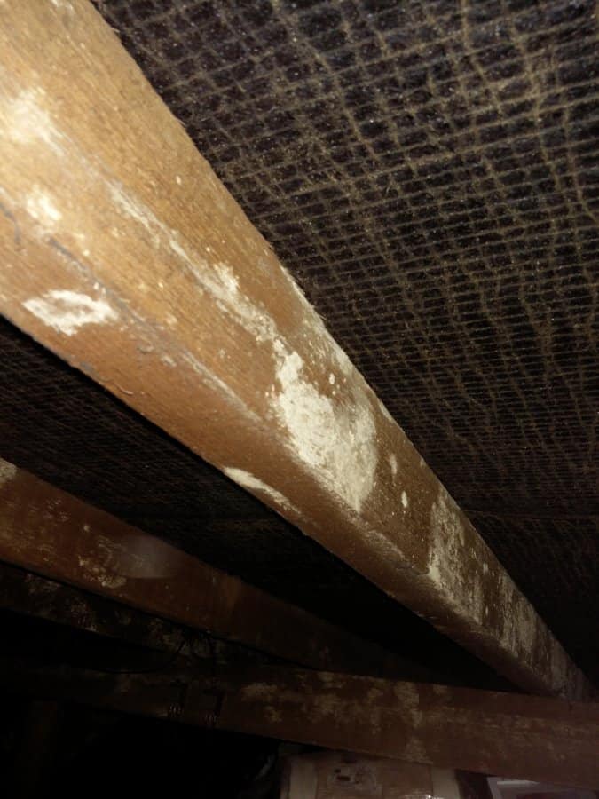

The principle is the same across all three: get air moving through the loft so moisture doesn't sit on cold surfaces. The differences are in how much work you're willing to do and how bad the problem is.
Good – basic ventilation upgrade
For a mild case in an average loft, adding vents is often enough. That typically means:
  • Soffit vents or over-fascia vents front and back, so air can enter at the eaves.
  • Roof tile vents higher up, so damp air can escape near the ridge.
  • Making sure loft insulation isn't blocking the eaves; fit rigid eaves trays if needed to hold the insulation back and keep an airway open.
  • Sealing and insulating the loft hatch properly so household air doesn't leak up.
Underside view of loft rafters with white chalky deposits and discolouration on the timber, dark mesh-reinforced bitumen felt above and stored items visible below.
The patchy, dry-looking deposits spread along the rafter face; note the non-breathable felt directly above, which restricts moisture escape.
This is a job a competent roofer can do in a day. It's where the second opinion in most cases will land, and it's usually enough.

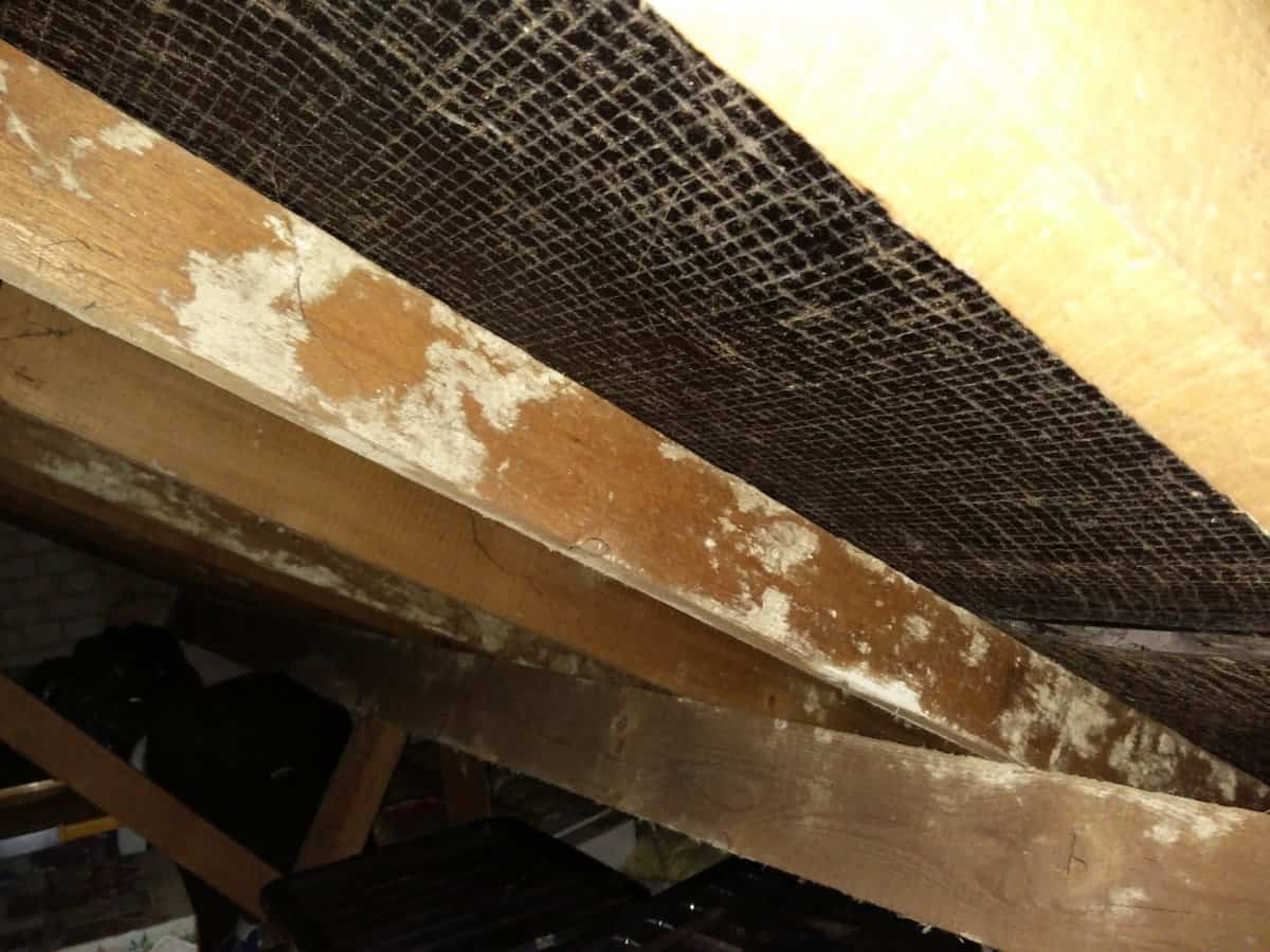

Best – full re-roof with breathable membrane (when the roof is due anyway)
If the roof is tired and coming up for replacement in the next few years, the proper long-term answer is to strip it, replace the old bitumen felt with a modern breathable membrane, and detail the eaves and ridge for ventilation as part of the job. Breathable membrane lets water vapour pass out through the roof instead of trapping it. It's a big spend, so I wouldn't do it just for this, but if the roof needs doing anyway, it solves the condensation issue at the same time.
Detailed close-up of a single wooden roof rafter showing white powdery residue, surface cracking and grain checking, with bitumen roofing felt in the background.
A closer look at the white residue and surface checking on the timber — the deposits are dry and dusty rather than fluffy, consistent with mineral salt deposits from repeated wetting and drying.

  • Spraying the rafters with fungicide and doing nothing else. Kills what's there today, but it'll be back within a year or two because the conditions haven't changed.
  • Cutting random holes in the felt. Doesn't create proper airflow, lets wind-driven rain in, and can void any roof warranty.
  • Stuffing more insulation right up to the felt. Blocks the eaves and makes condensation worse.
  • Venting a bathroom or tumble dryer into the loft. I've seen this more times than I can count, and it's guaranteed to cause damp up there.
  • Ignoring it because "the timber looks dry now." Lofts dry out in summer. Come November it'll be wet again.
