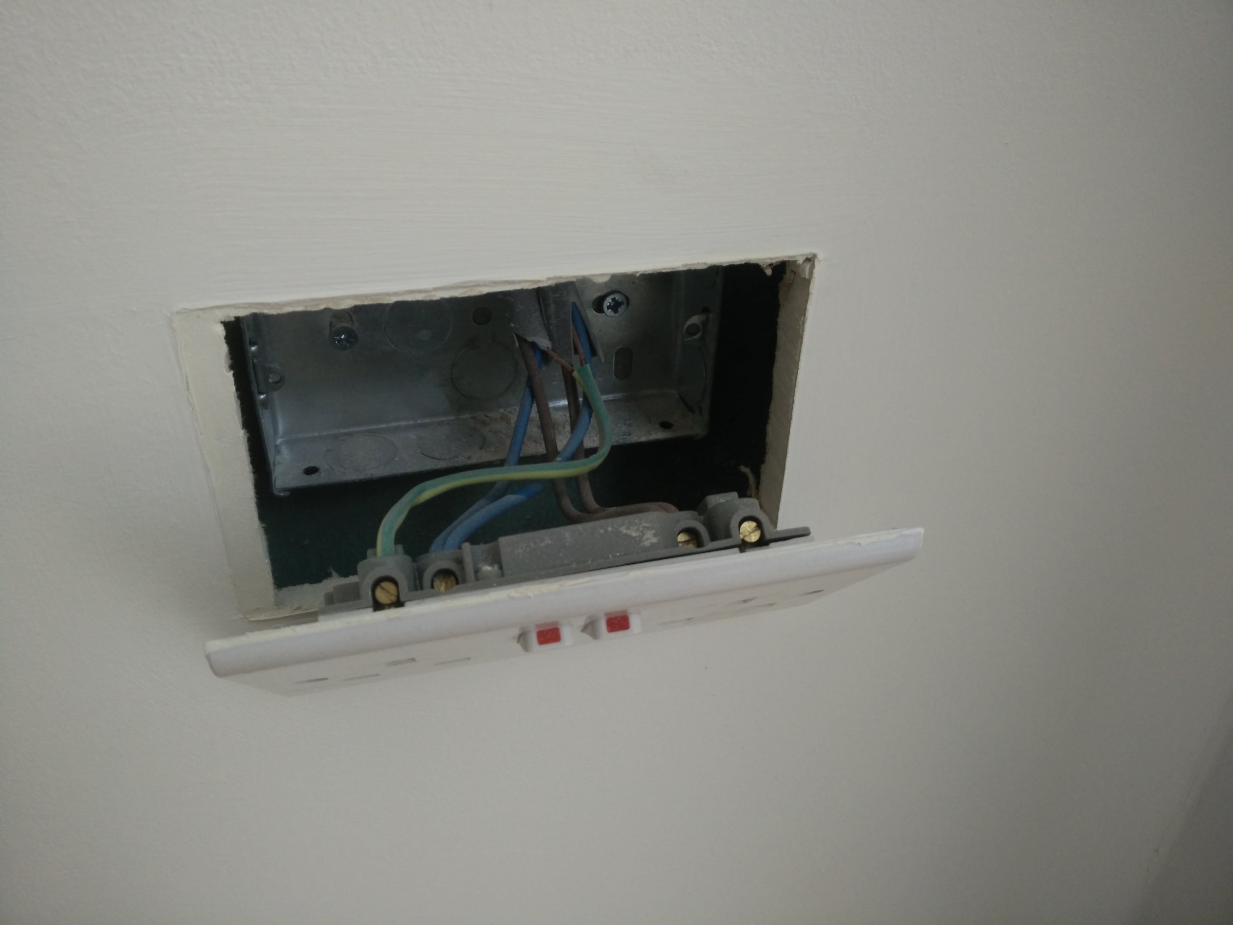

A homeowner in a 2009 new build has taken off a twin socket to spur off a fused connection unit and found the metal back box screwed straight to the blockwork behind, with a big gap between the front of the box and the face of the plasterboard. The face plate was being held on with extra-long screws bridging that void. The wall isn’t dot-and-dab, it’s plasterboard on metal vertical studs fixed off the block. On top of that, the earth terminal inside the back box has no fly lead fitted. The question is whether this is safe, whether it meets the regs, and what the tidy fix looks like.

What’s likely going on
On a metal-stud plasterboard wall in front of blockwork, the sparks usually screws a standard galvanised back box (25mm or 35mm deep) to the block during first fix, aiming to get the front lip roughly flush with where the finished plasterboard face will be. If the boarders then pack out the studs to correct a bow or curve in the wall, which is exactly what’s happened here, the plasterboard ends up proud of where it was meant to be. Result: the back box is now recessed well behind the finished surface, and the socket front plate is being asked to bridge a gap it was never designed to bridge.
The practical problem isn’t that the socket won’t work. It will. The issues are:
  • The terminals on the back of the accessory are effectively sitting in the stud void, not enclosed in the box.
  • Anything living, or anyone later fishing a cable down that void, could touch live parts.
  • The fixing lugs are taking load through long screws with very little support, so the plate can flex when you plug and unplug.
  • Dust, debris and draughts can move in and out of the void through the accessory.
On the missing earth fly lead: if the back box has at least one fixed (non-adjustable) lug, the metal-to-metal contact between the accessory’s fixing lug and the back box is accepted as providing earth continuity. Only when both lugs are the adjustable or floating type do you strictly need a separate green-and-yellow fly lead between the accessory earth terminal and the earth stud in the box. So the sparks isn’t necessarily wrong there, but a fly lead is cheap belt-and-braces and never hurts.

Good, fit a plasterboard (dry-lining) box
If the hole in the board is the right size, or you can neatly trim it to suit, the cleanest answer is to remove the metal box from the block, transfer the cable through a grommet into a plastic dry-lining box, and clip that into the plasterboard. The spring lugs grip the back of the board and pull the box tight to the front face. The accessory then sits properly in the box, terminals enclosed, front plate flush. Job done.
This is the fix I’d go for nine times out of ten on a stud wall where the block is too far behind to be useful.
An open metal back box recessed into a plasterboard wall, showing blue, brown and earth wires connected to terminals, with the white twin socket face plate hanging loose below the box revealing a large gap between the box and the plasterboard surface
The back box is set too deep into the wall, leaving a void that the original face plate was bridged across with oversized screws.
Better, deeper metal box with a packer
If you want to keep the metal box (some people prefer them for robustness, especially on sockets that get a hammering), swap the 25mm for a 35mm or 47mm and pack behind it with a timber or ply block cut to fit, screwed to the block. That brings the front lip of the box up to the plasterboard face. Grommet the cable entry, refit the accessory, and if you like, add a fly lead to the earth stud.
More work than the plastic box, but a solid, long-lasting result.
