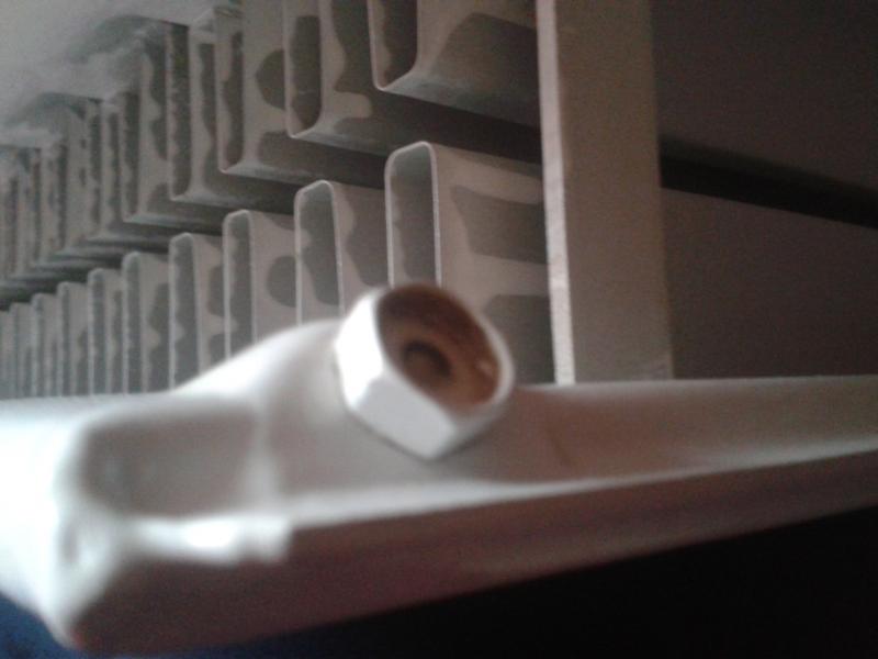

A homeowner has snapped the little square-drive spindle off the bleed valve on one of their radiators. The bit you put the key on has sheared clean off. The heating system is a regular (non-combi) system boiler, and they want to know whether they can just swap the bleed valve out without draining the whole system down, and how to go about it without making a mess. Sensible question, and yes: nine times out of ten this is a job you can do yourself in half an hour.

  • Look at the bleed fitting itself. Is the whole boss corroded, or just the little spindle? If only the spindle has sheared, you just need a new bleed valve screwed into the existing boss. If the boss itself is knackered, you'll be unscrewing the whole hex plug and replacing that too.
  • Check the thread size. This is the one that catches people out. Standard UK bleed valves are 1/8" BSP, but some manufacturers use their own slightly different sizes. Take the old one with you to the merchant so you can match it exactly. Don't guess.

If only the bleed spindle has snapped and the boss is sound:
1. Turn both radiator valves fully off. Count the turns on the lockshield so you can reset it afterwards. This keeps the system balanced.
2. Put an old towel and a small container under the corner you're working on. Water spillage will be minimal but it's usually black and it will stain carpet, so protect the floor properly.
3. Using a spanner on the flats of the small bleed valve (not the big hex boss), gently unscrew the old bleed valve anticlockwise. You'll get a dribble of water. That's normal.
4. Wrap 4-5 turns of PTFE tape clockwise around the thread of the new bleed valve. A smear of jointing compound on top is belt and braces, but PTFE alone is fine for this.
5. Screw the new valve in and nip it up snug. Don't gorilla it, brass strips easily.
6. Reopen both radiator valves (lockshield back to the same number of turns), then use the bleed key on the new valve to let the air out until water runs steady.
7. Check the boiler pressure afterwards and top up via the filling loop if it's dropped below about 1 bar.
Better (whole boss and valve)
Close-up of a radiator bleed valve with the square-drive spindle sheared off, leaving only the hexagonal brass body visible at the end of the radiator header.
A broken radiator bleed valve with the square spindle snapped clean off, making it impossible to use a standard bleed key.
If the boss looks corroded or you can't get the sheared valve out, unscrew the entire hex boss from the radiator end cap. Same principle: PTFE the thread, wind it back in. You'll lose a bit more water this way but still nothing dramatic if both valves are properly shut. Match the boss thread carefully, it varies between makes.
