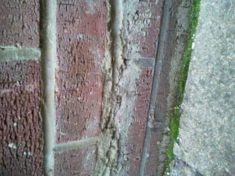

Close-up of a weathered red brick wall at ground level showing cracked mortar joints and a gap between the brickwork and a bed of gravel
Deteriorating mortar joints and a gap at the base of the wall where it meets the gravel bed — a common entry point for water at low level.
If all your damage sits low down, on the exposed side, and the gutters are fine, you've got your answer – it's frost damage on soft facing bricks. Don't guess, prove it.

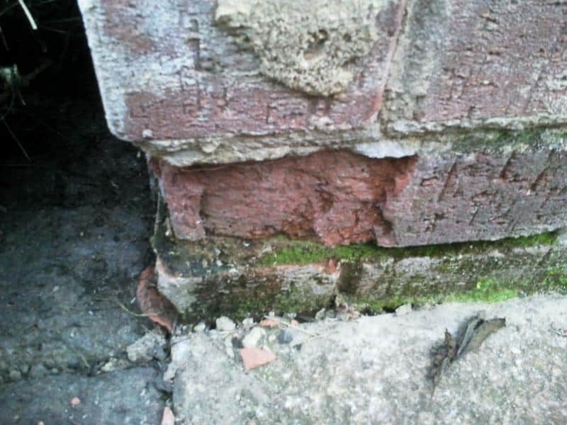

Detail of red brick wall showing spalled brick faces, crumbling mortar, and green moss growth along a vertical joint near a concrete surface
Spalled brick faces and failing mortar near ground level, with moss growth indicating persistent damp in the joints.
If you're already having someone in, spend the extra and specify frost-resistant (F2 rated) engineering or facing bricks for the replacements, especially on the exposed side of the house. They cost a bit more but they'll shrug off another 50 winters. While you're at it:

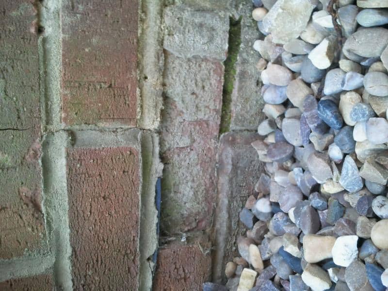

Bottom corner of a red brick wall showing heavily spalled and crumbling bricks at damp proof course level, with moss on the mortar and fragments of brick on the ground
Significant brick spalling and crumbling at DPC level, with loose fragments on the ground — typical freeze-thaw damage at the base of a wall.
