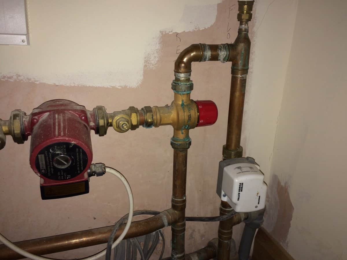

Underfloor heating pump, blending valve with red temperature dial, and motorised actuator mounted on copper pipework in a plant room.
The circulation pump, blending valve and zone actuator — the key components to check when a UFH zone stops responding.

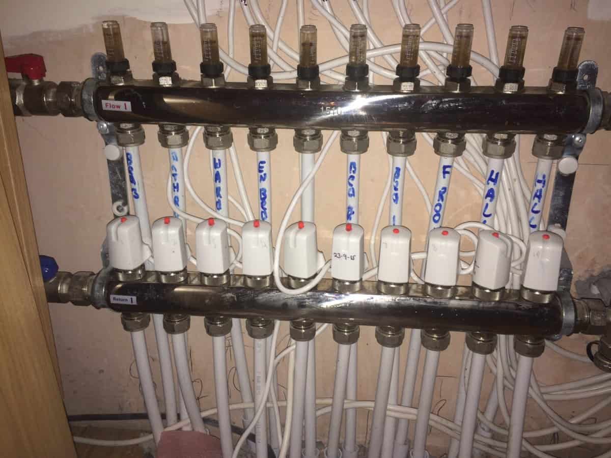

  • Lift the actuator off and look at the brass pin underneath. Push it down with your finger. It should spring back up smartly and travel a good few millimetres. If it's sluggish, sticky, or barely moves, the valve pin is seized. Very common after years of sitting shut. A sticky pin means the actuator can push it down but can't lift it back open.
  • Compare that pin's travel with a working loop's pin. Side by side is the clearest test. If the problem pin sits noticeably lower or moves less, that's your smoking gun.
  • Check the flow meter (the clear tube with the float) on that loop. With the system running and all other loops shut, the float should show a reading similar to the others, typically 1 to 2 litres per minute for a domestic loop. If the float is jammed at the top or bottom, the meter itself is gubbed and needs replacing so you can actually balance the circuit.

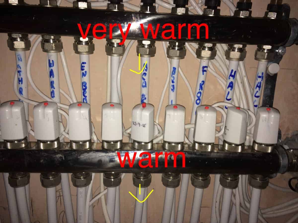

  • Feel both pipes at the manifold for that loop. Flow should be hot, return noticeably cooler. If both are stone cold, no water is moving. If both are equally hot, water is racing through with no time to give up heat, usually a balancing issue.
  • At the thermostat, turn the setpoint well above room temperature and listen at the wiring centre. You should hear a faint click as the relay pulls in, and within a couple of minutes the actuator head will warm up slightly as its wax capsule energises. No click = control problem. Click but no actuator movement = wiring or actuator fault.
  • Check the actuator is wired to the correct zone on the wiring centre. On multi-zone jobs it's not unusual to find a room stat driving the wrong actuator. Get someone to turn each stat up in turn while you watch which actuator pin rises.
  • Look at the loop length if you can find the original layout. A loop much longer than the others (over about 100m in 16mm pipe) will struggle, especially if the pump speed or blender temperature is set low.

UFH manifold showing flow and return bars with multiple labelled white pipes, flow meters on the flow bar, and white thermal actuators on each return port.
A typical multi-zone UFH manifold with individual actuators and flow meters — each port serves a separate room or zone.

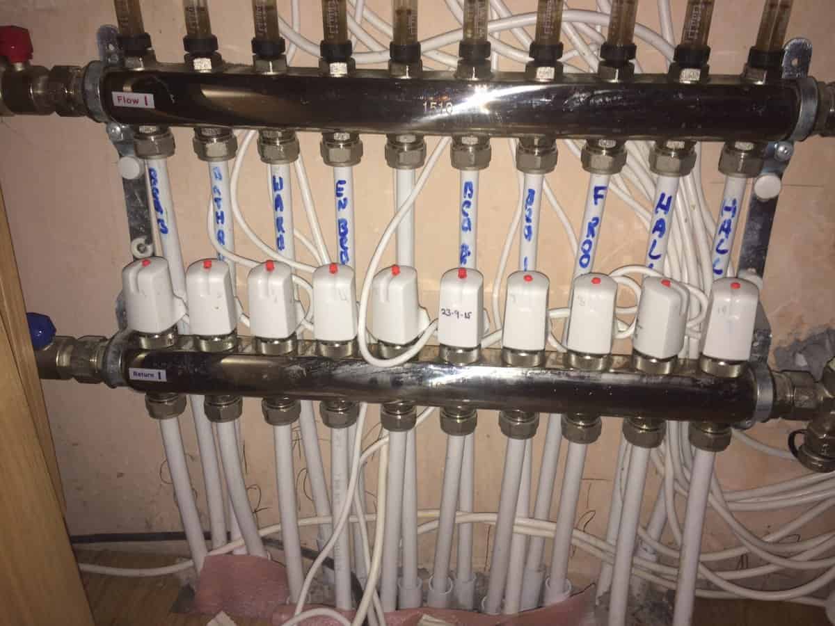

Good: pop the actuator off, free the valve pin with gentle taps and a smear of silicone grease, refit, and have a competent person meter out the wiring from the room stat through the wiring centre to the actuator. Confirm 230V arrives at the actuator when the stat calls for heat. Replace the dud flow meter cartridge so the loop can be balanced properly. Nine times out of ten that gets it going.
Better: do all of the above, then rebalance the whole manifold from scratch with every loop's flow meter working. Set the blender (mixing valve) to a sensible flow temperature, typically 40-45°C for screed, a bit lower for timber floors, and set the pump to the speed the manufacturer recommends for the number of loops. Get the room stats set up with a proper programme rather than just on/off, because UFH is slow to respond and needs to be ahead of demand.
Close-up of UFH manifold flow and return bars with flow meters visible at the top, white actuators on the return ports, and pipes labelled in blue marker pen.
Flow meters on the top bar allow each loop to be balanced independently — misadjusted meters are a common cause of poor zone performance.

UFH manifold with annotations showing the flow bar labelled very warm and the return bar labelled warm, with yellow arrows pointing to a single pipe on each bar.
A temperature difference between flow and return confirms water is circulating through the loop — useful for ruling out a blockage or closed valve.
