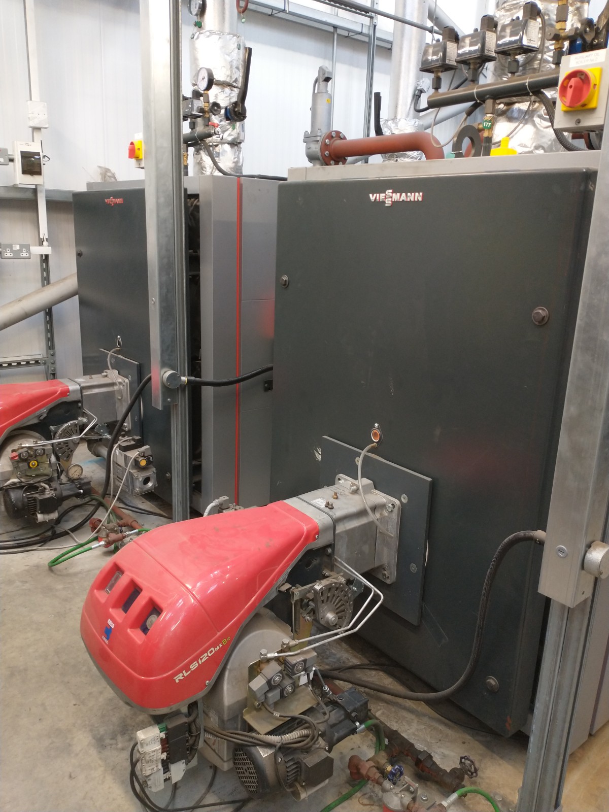

Filter setup for 2 pipe arrangement doesn’t allow for air release. Each pump should have an separator or the return lines should go back to the tank.
Unless I’m mistaken it looks like the return lines link back to the flow lines.
