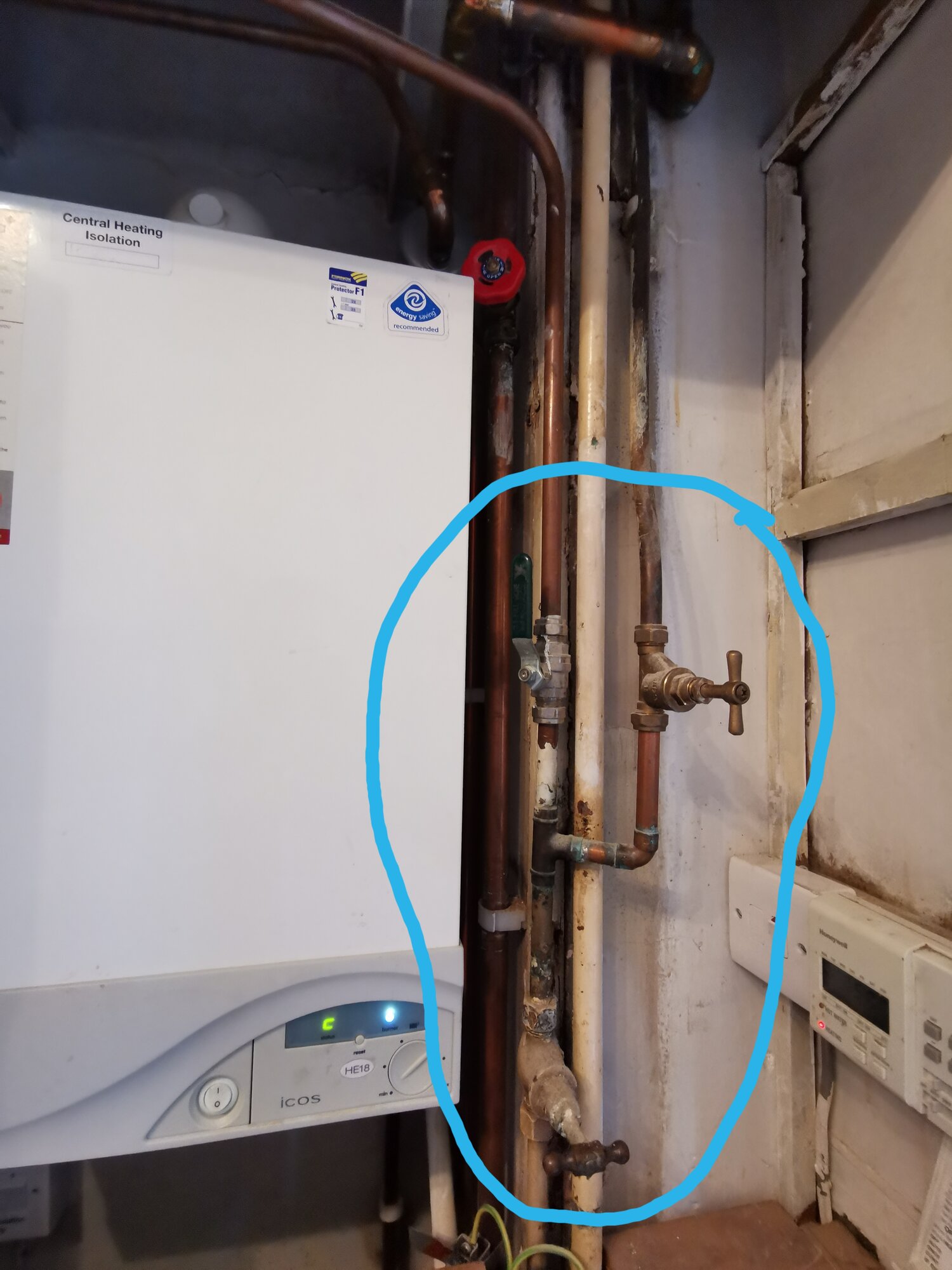

Your new boiler will be a sealed system boiler, and I would think this pipework is related to the feed and expansion tank of an older system. Follow the pipework into the loft to check whether it is still connected.
