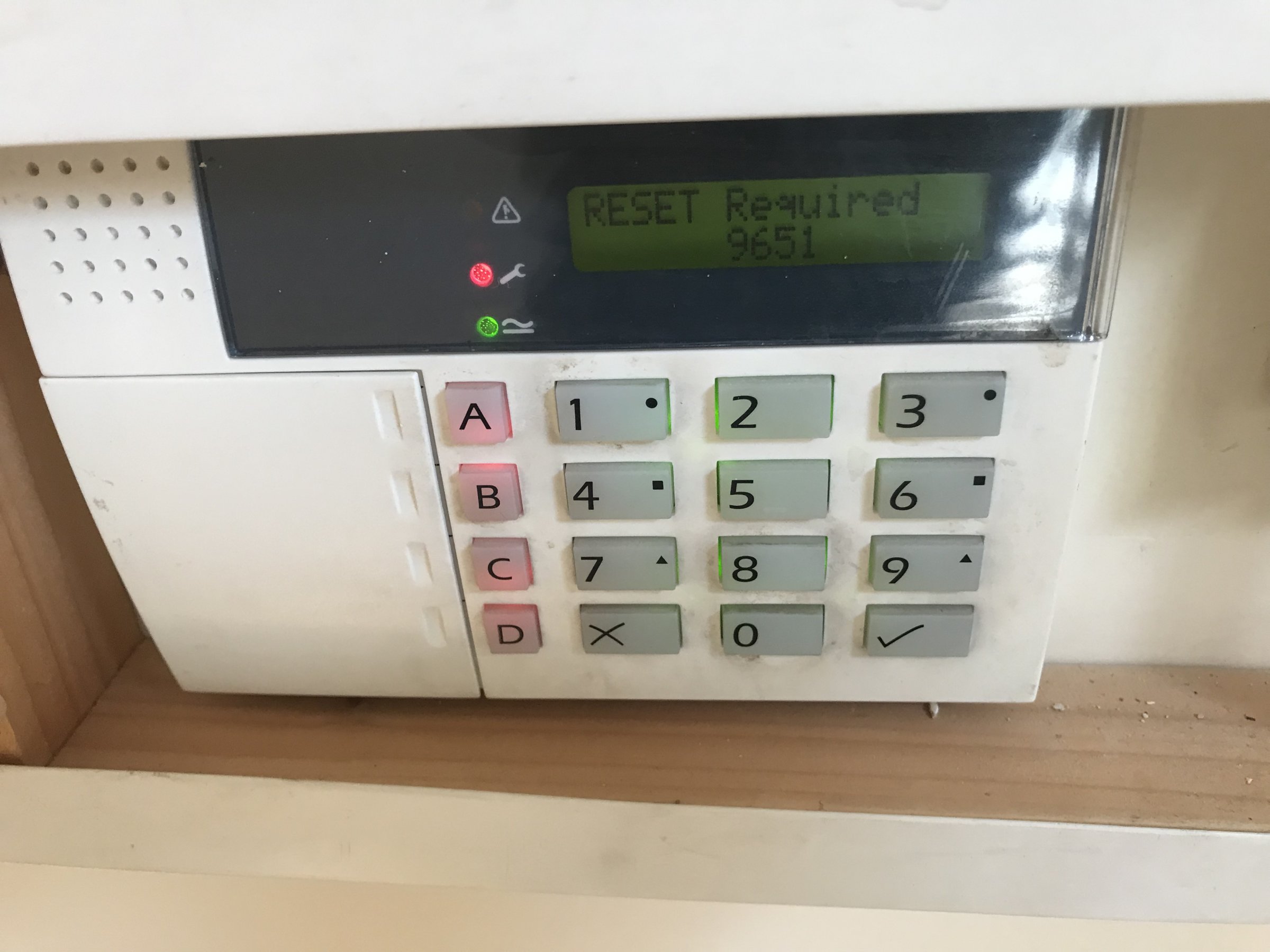

IMG_3831
Error message
It’s probably set for engineer reset on lid tamper, do you have the engineer code ? Default is 7890...if not you may have to do a stage 1 reset if you feel your up to the task
