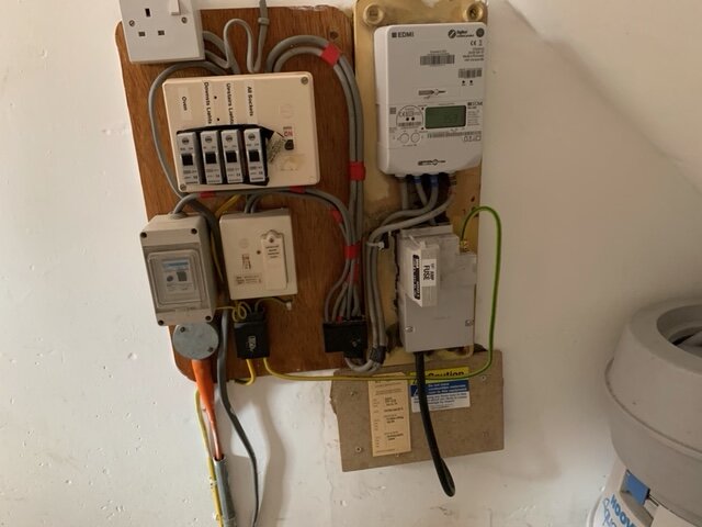

Original "fuse box" with newly installed smart meter
normally given the age I would say 99% likely you will require a bonding upgrade.
The distance between CU and pipes doesn't matter, it only increases cost slightly.
However the green/yellow wires look more modern than expected, where does that green/yellow near the orange go?
Maybe a photo of the water stop tap and gas meter would be more useful, looking for green or bare wires
