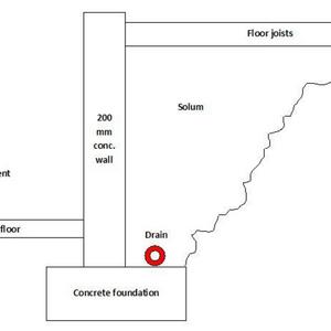

    Can anyone advise on waterprrofing rock face in solum?
    Thanks for that. It was a quick sketch to show the shapes so I didn't put all the details in but the drain will be wrapped in a geotextile.
  5. A
    Here's a picture. As a belt and braces approach, the wall at the back of the basement has been designed with the strength to retain whatever is thrown at it. It's eight inches of reinforced concrete. In fact, the ground behind the wall won't touch it as the rock face is stable and is about...
  6. A
    Thanks for the replies. The site doesn't slope that steeply. The rock face in the solum is steep because it sits behind what the amercicans would call a walk out basement. It's not going to be an area that is used at all. I am hoping that there shouldn't be much water trying to come out...
  7. A
    I am building a house (for me) which is on a rocky, sloping site. There is a solum behind the rooms downstairs at the front that rises steeply and then levels off. The face of the steep bit is a very uneven rock surface. Has anybody got any suggestions about how I can treat this to seal...
