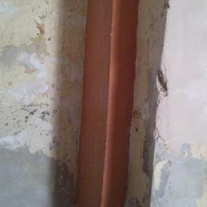

    chimney question
    Im really not sure, but seems to me like an old vent of sorts. This is the chimney breast in our kitchen and to my knowledge has never had a fire installed. It sems to be metal but covered in paper and several layers of paint, so not certain. The bottom, where you can see in the photo, has...

    chimney question
    Hi Whats this on the side of my chimney breast and how might i go about removing it? Thanks Alp [/img]
