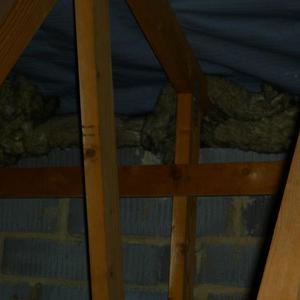

    condensation in loft
    thanks mate plent of things to go on there. my current fan is an axial - not at home at the moment so dont know which make or model. will have a look at the duck and will probably insulate it. would there be any point in reinsulating the whole loft? cheers
    cool I will pull out the insulation and see if it helps. the bathroom ventilation might actually be a problem. its an internal bathroom with no windows and a fan on the ceiling. its goes on with the light and stays on for 10 minutes after the light is switched off, the condensation on the...
    we dont dry clothes in flat there is an extracter fan in the bathroom ( although the bathroom has no windows and the duct is about 6 metres ) there are no leaks in roof or holes in ceiling etc
  5. A
    Hi I have read other posts but just wanted to double check. As you can see there is alot of condensation and it leaves the ceiling above the windows mouldy. There is no moisture rising up from the rooms below, there are two vents on the roof, water tank is covered etc. The only reason I can...
