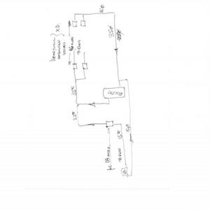

    Heating zone control
    Thanks D_Hailsham Sorry for my sketch, it is a two pipe system, and yes it is a 41kW output, 51kW input Concorde CX140 I am looking to replace this with a Worcester 40Cdi, hence trying to decide the pumping and control circuits The pump does seem adequate but is not...
    Thanks for reply, just spent two hours trying to get diagram on page Hope the address above work xxxxxxxxxxxxxxxxx It shows the boiler output splitting into 35 & 22mm pipes The 35mm splits into two motorised valves feeding two rad circuits - each...
